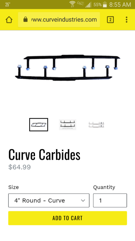

When purchasing new carbides for the curves does stud boy woodys make them for curves or are they a std bolt pattern?
grizztracks
Tech Advisor
- Feb 24, 2005
- 3,116
- 971
- Scio, NY
Same as the C&A skis, Part number for 6" Woody Slim Jim (change 6 to 4 or 8 for length of carbide)
#SC6-5000
#SC6-5000

Curve also sells carbides. I think I bought a set once.
I've ran those and they wear well. I've also tried the Stud Boy Shaper bars a couple times and they don't last on the Curve skis for some reason. They wear in front of the carbide and eventually break with relatively low mileage. I've also had good luck with the SnowStuds Magnum series carbide for Curves XS skis #RM8906.

I’ve got everything ordered except the carbides. I’m going to check my local dealers prices first. They usually are quite comparable to online places. I think I’ll try the stud boy round bar in the 6 in length. I did not get the leading edge for these. I want to try these first and see how it feels. I got the mounting rubbers and bolts direct from curve industries. Wanted to make sure I got the updated rubbers I heard about. Price was about the same as EBay. The hosed me on the shipping though! $22 bucks! Stuff must be riding first class!
