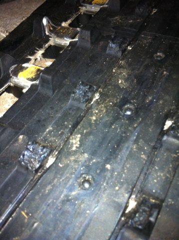

So I pulled the skid out of buddies viper and when I pulled it out I noticed all this wear on these nubs on the inside of the track. I have no clue what would of caused this, this has happened since the last time the skid was out. Has anyone ever seen this before or know what would cause this? The track is a 1.6" ice cobra with 5500km on it, the track is in mint condition other then this now.
UPDATE:
I got looking at this a bit more and it almost looks like the mounting location for the rear shock i flipped over the wrong way, looks as someone had the torsion springs undone and when put back together the mounting location for rear shock folded down in and was making contact with track.
