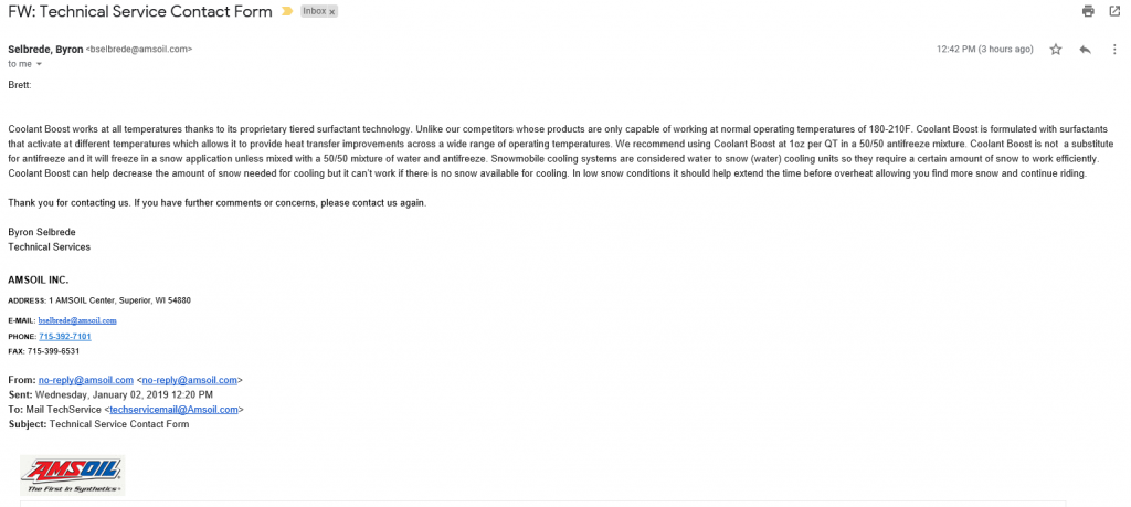

I have read a number of people on TY may be using Water Wetter in their sleds cooling system. After researching a number of threads on here I found this one that mentions Amsoil's Dominator Coolant Boost above. Curious, I sent an email to Amsoil's Tech mail box the other day asking about running this product in a snowmobile and just received this response. Thought I would share. G.B
