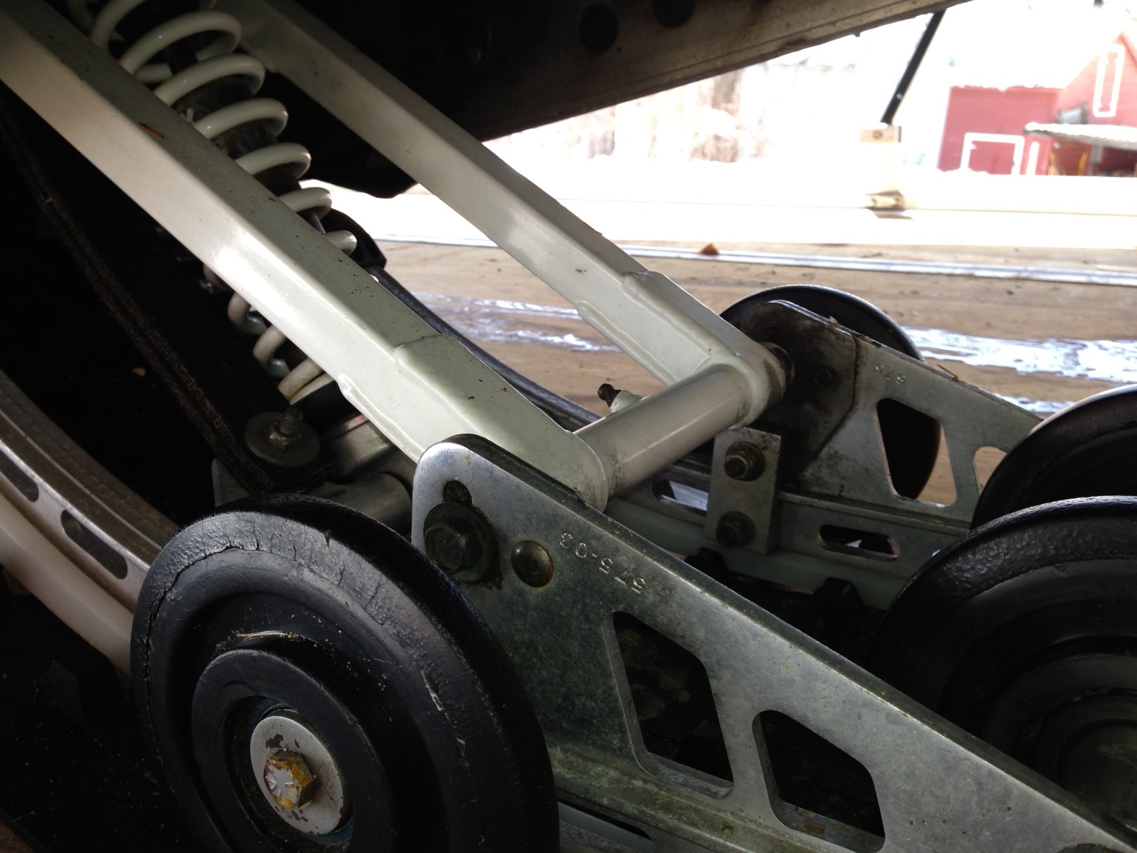

od is 7/8....id is3/4 at least thats what i came up with and have them on order should have them by thursday well see,,the were like $2.50 a piece.1/8 inch wall thinkness.if they work i will let you guys know where to get them with a part#.these are nylon bushings but for the price and a hour worth of work ill replace them every couple years as needed.also add a zerk fitting and they might last for years

nope didnt work,i dont know what i was thinking they are metric duh,what a waist of time lmao..and then looked them up and they are only about 5 bucks a piece.i dont know what i was thinking but i tried
