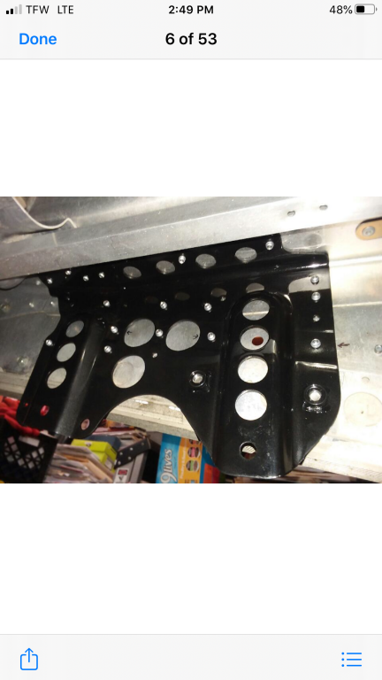

Yes I wouldn’t do it any other way,if you look at the parts pictures of your sled& the apex ltx you will see the differences,you will need 2 rear mtg brackets #30,31 that rivet in place& will line right up(usually avail good used or about$100 new for the pair, the 136 track,rear suspension assy,2 rear idler wheels& wheel standoffs(get new or used from 2012,2013 vector ltx as it’s a simpler design,the upper drive gear in the chain case was 1 tooth difference between a 121&136,I did not change gearing& most other people didn’t& it works fine with the 121 gears as you have plenty of hp/torque to run the 121 gearing.i will send you various pics of what’s neededSo I should just get a whole newer 136” ltx suspension and be good to go other than relocate the carrier wheels? The new carriers are 21” from the current ones are? Thanks for the help.

View attachment 153633Thank you I appreciate it! Looking forward to the pics.
this is the bracket you will need to use for the 136Thank you I appreciate it! Looking forward to the pics.

View attachment 153634 View attachment 153633
