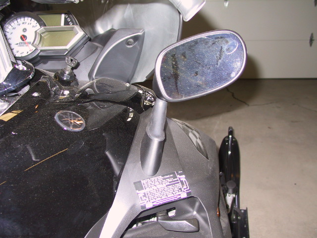

Anyone know anything about the mirrors in the 2007 Yamaha accessories catalog. Shows two different types one type must mount on top of side cowl and the other maybe handlebar mount. This is the one I am questioning, part no. 8FP-W2628-01-KT. Any info appreciated.

The part number you have for the kit above is the style that mounts on the side panels. This has been the only kit released by Yamaha to fit the Apex/Attak style sleds. The 07 accessory catalog has a misprint as the other number they show for Apex mirrors supersedes to the number above. Also the picture shown is that of the kit to fit an RX/RS body style sled (RS Venture style kit).

i just installed the new yamaha mirrors on my 07 apex - i think the mounting blocks are new (not sure i never seen the 06 mirror set up it might be the same) the 07 kit i got mounts to the side covers but on the top - they give you a new reverse sticker for your side panel - they mount there - they seem to be very soild and look factory - i haven't rode with them so i do not know about the vision - seems to be poor to fair - not as good compared to my 06 yamaha vector mirrors but looks better - i am glad i went with them - (they do fold in and i can see more then my knees but not much more)

I got the kit pictured above on 06GT's sled. It does come with a template, actually two, one for each side. You have to use tape to hold the template on to mark the holes, they aren't self-adhesive. Finally got at chance to try out the new mirrors on a trip across Lake of the Woods between Xmas and New Years. They aren't nearly as functional as the mirrors on my 99 vmax, but they do definitely help. I found I have to move my head around to see what I'm looking for in the mirrors, on my older sled, that wasn't necessary. One thing that would improve them is if the mirrors were slightly convex, they are just flat glass. You know the "objects are closer than they appear" type thing, you get a much larger field-of-view if they're convex. I do tend to see more of my knees with these new mirrors than I need to. Also, the gauntlets on my gloves have a tensioner cord for the cuffs that seems to be right in the way - most of the reason I need to move my head around to see. It would also help if they had a larger range of movement in the ball sockets. To sum up, they do the job, but not as well as I hoped.
