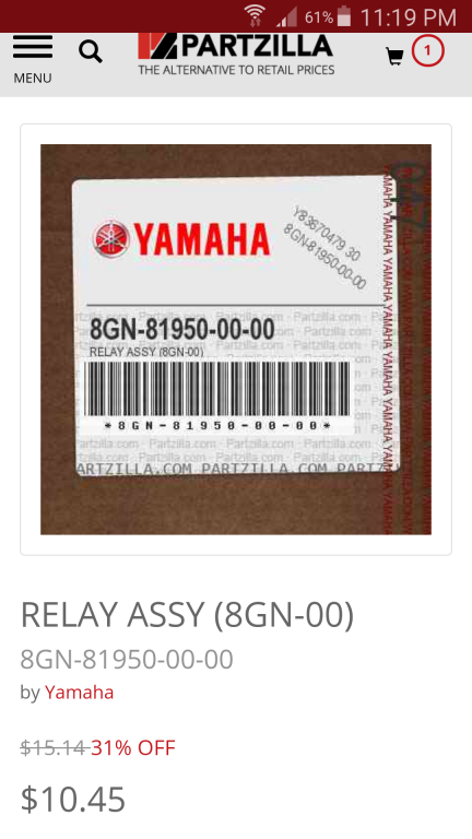

So my perfect low km 06 was outside for 3 hours in -18 c......after goin for a rip and she wouldnt start. Turn over fine....normal speed..... till the battery went dead.....new battery.....and no go. Brought it in the shop for 15min and she fired up. Is this what i have to look forward to?

Nope, Type Red Relay into search function and read away. easy fix

Depends. If your fuel pump relay is in fact freezing, then yes, yes it will. The easiest way to tell is to locate the relay, and put your fingers on it when you turn the key on. If you feel it click, your relay is fine. If you don’t feel it click, she could be frozen.

do this test when cold and don't start obviouslyDepends. If your fuel pump relay is in fact freezing, then yes, yes it will. The easiest way to tell is to locate the relay, and put your fingers on it when you turn the key on. If you feel it click, your relay is fine. If you don’t feel it click, she could be frozen.

As your sitting on the machine with the plastic cover removed, which one of the 4 relays is the feul pump relay?

As your sitting on the sled its the 2nd from the left, However some have said different. look for 3 red and one blue wires leading into the relay plug and your good.
