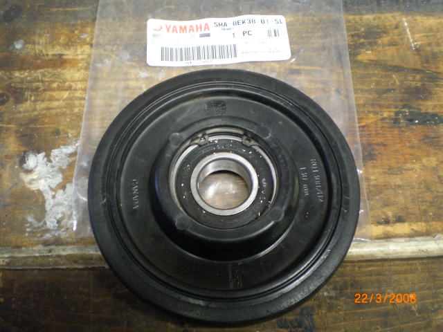

The rear idlers are the large one towards the back-end of the sled. There are two inner idler wheels and I believe they are about 5.25" in diameter.

You only have to machine the MOUNTS if you use a larger bearing, OEM'S are "6005" 12mm in width, if you use a "6205" which is 15mm in width your 3mm wider so your not going to centre between track cogs on the rear inner idlers and will DEMOLISH them in no time...been their, within 5 miles they were TOAST!
All what I'm trying to say here is to make sure you replace with the same BEARING size on the WIDTH, most DOO & POO idlers run with the wider "6205" while we YAM'S run with "6005" OEM.

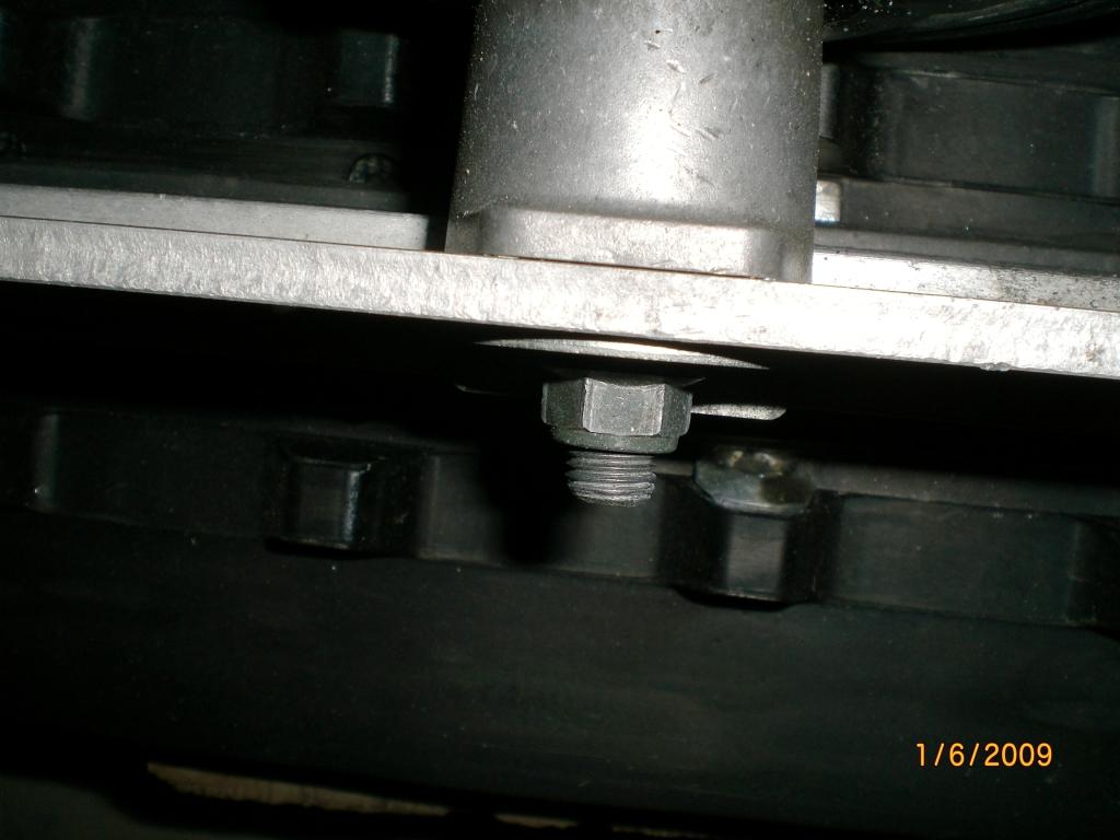

You only have to machine mounts if you use a "6205" type bearing, the size of idler has nothing to do with mounts. Here are a few pic's of my inner rear w/machined mounts...these idlers are YAM 5.125" OEM size w/replaceable "6205" bearings, they have close to 10.000kms and going strong

How do you machine the inner rear. Do you just shave a small amount off on the rail side of the mount? Roughly how much needs to come off? Thanks.

I spun them on a lathe and shaved down 1.5mm on the wheel side of the mount.
Another way is to get a Skidoo wheel mount that accommodates the wider bearing. They use 2 bolts to mount up, which can be stronger than Yamaha's 1.

insane said:How do you machine the inner rear. Do you just shave a small amount off on the rail side of the mount? Roughly how much needs to come off? Thanks.
I shaved 1.5mm on rail side with the use of a milling press...
black knight
remove 1.5mm on the mount for the 6205 bearing only to center inline with track lugs and only need to do this to the 2 rear wheel mounts.
