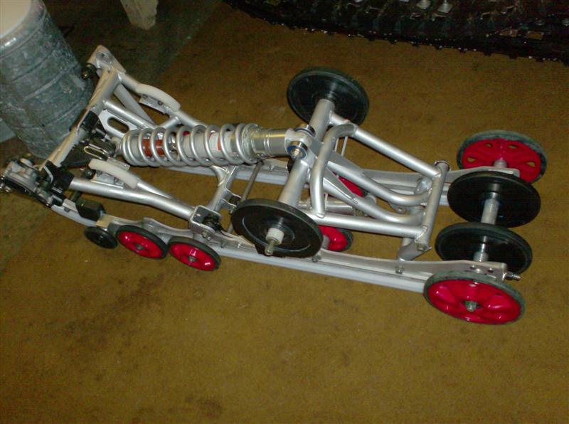

I have a 2009 Apex MTX. Some of the idler wheels sound rough. Can not change the bearing b/c Yamaha in all their wisdom decided to use a wheel that can not have the bearing changed. Broke one last year , $65 from Yamaha. I think ones with changeable bearings will work on the four on the outside of the rail( borrowed from a SRX) even though the bearing is a little wider. What about the two on the bottom of the front arm shock? The big ones on the back and top of the scisor are okay for now. Any suggestions on those? Thanks

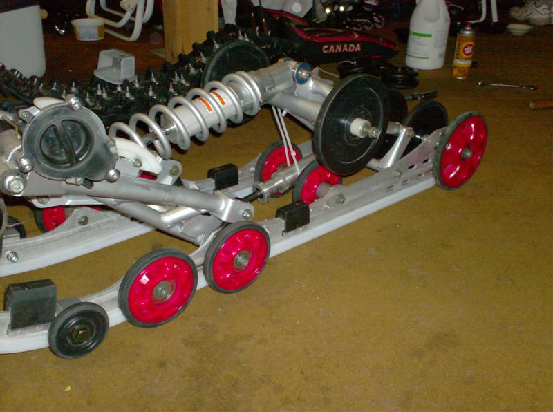

WNR18 said:I have a 2009 Apex MTX. Some of the idler wheels sound rough. Can not change the bearing b/c Yamaha in all their wisdom decided to use a wheel that can not have the bearing changed. Broke one last year , $65 from Yamaha. I think ones with changeable bearings will work on the four on the outside of the rail( borrowed from a SRX) even though the bearing is a little wider. What about the two on the bottom of the front arm shock? The big ones on the back and top of the scisor are okay for now. Any suggestions on those? Thanks
All these are new Yamaha wheels with replacable bearings, every wheel you see has them.
mr. shide
will those all fit an 06 apex gt, directly bolt-on? Nice looking skid BTW.
shadow44
Yep, they're the new Yamaha wheels that come on all 2010 sleds

mr. shide said:will those all fit an 06 apex gt, directly bolt-on? Nice looking skid BTW.
Yep, what Shadow said, and thanks for the compliment

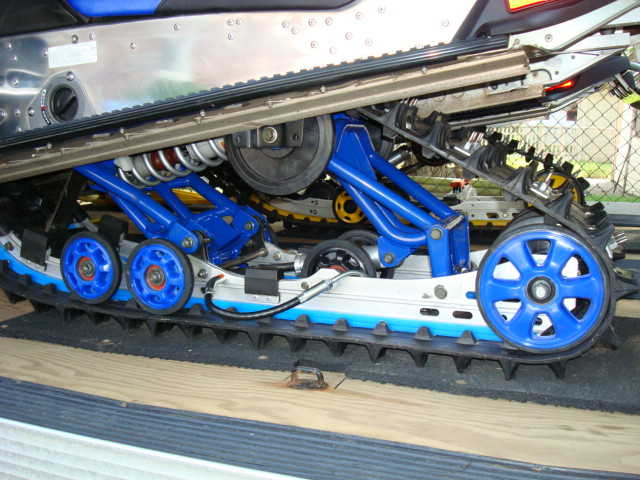

Nick1945 said:My '07 Apex skid, after a trip to HalfBaked for a Beef-Up Kit, and all new updated wheels and bearings, and bushings, a 4th wheel kit, and revalved mono, and a set of SlideKicks.
Your skid looks great Nick, nice job!

all nice... but the original question was for an apex MTX with 6005 innner bearings/comes with wheel mount.. (same a 07-09RTX) and nytro suspensions...
to the question.... the "wider" wheels with 6205 bearings will not work in the centre.... without mods...
