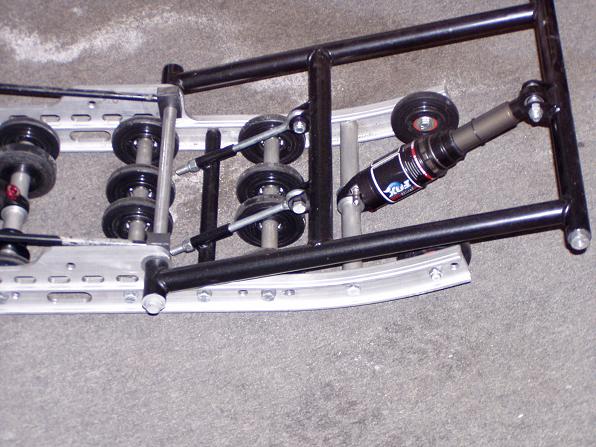

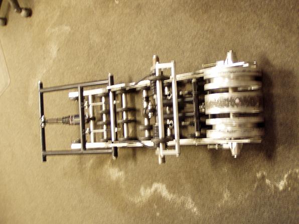

I have 6,000 miles on my '06 Attak and after pulling out the skid, most of the idler bearings are junk. That's the by-product of running trails in the U.P. that were mostly minimal snow to all out junk last winter. Don't get me wrong, I would run it all over again!
Anyway, the question is, I know that when Yamaha initially had supplier issues with idlers, a lot of you found alternates to purchase and install in the skid. I really don't want to pay Yamaha part prices here (as in OUCH!!) and was wondering where to look for quality replacements.

Thanks to everyone for their usual quick and informative replies! I just placed my order with Rich Motor Sports. Being slightly oversized (to reduce slide wear) was the deciding factor!
