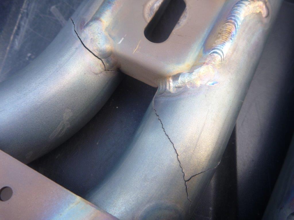

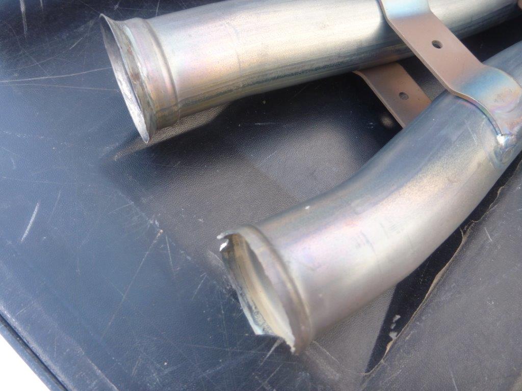

Ok I found the exhaust cracked in half on the pipe feeding to the rear muffler. I am going to weld it but can't figure out if the pipe is stainless or not. It is magnetic but it has no rust and is lightly blue from heat. Any ideas?
chadman
I would say that it is stainless steel. Titanium is not magnetic it is paramagnetic.
Force4000 said:Ok I found the exhaust cracked in half on the pipe feeding to the rear muffler. I am going to weld it but can't figure out if the pipe is stainless or not. It is magnetic but it has no rust and is lightly blue from heat. Any ideas?
Regular mig welder will work on the pipe that is connected to the muffler. Had mine split at the Y and welded it up with no issues.

lots have welded it and had it hold up a long time even if it only lasts a year or two better then a $500.00 silencer.
Force4000 said:I took it to a welding shop and they said being it is low grade stainless steel and that I want to have it TIG welded with a EF409 filler. I have attached some pictures of the snap. What did you use with your MIG welder? has it held up for a long time?
Just used a regular wire feed mig. Mine broke halfway thru the season. The weld has about 1000 miles on it and its still good.
Force4000
Thanks for the response, I had my buddy just MIG it together with standard 309. I will grab some pics when I pick it up after work
