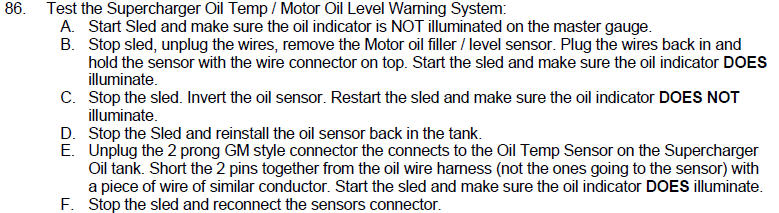

Here is what you need my friend, your not testing the sensor correctly this the process from the MPI manual basically holding the sensor up right and out of the oil and then upside down and out of the oil should get the light to come on or off. Good luck

kinger said:Here is what you need my friend, your not testing the sensor correctly this the process from the MPI manual basically holding the sensor up right and out of the oil and then upside down and out of the oil should get the light to come on or off. Good luck
PS ignore anythign related to the MPI supercharger kit
Thanks, I'll try this out.

check the sensor per the owners manual specs. I'm sure you measure the resistance in ohms, determine if its the sensor or ECU

Hey guys, well I found out my low oil light does work due to another oil related situation.
But I think if you did leave the dipstick connected to the wiring and held it out of the tank it should alarm in a bit.

The sensor in the dipstick can get clogged up, blow clean with compressed air and it will start working again. The low oil level light will not come on until you are close to the sensor housing on the dip stick. Just under E is plenty of oil, remember E stands for Enough not Empty. The Apex engine also have an oil pressure sensor to protect the engine, the RX-1 engine have not.

I now realize the oil seems to need to be below the "E" to alarm in. It is working though.
