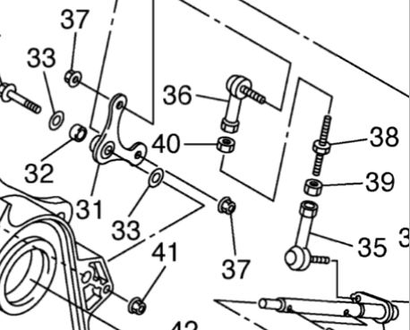

Below is the reverse linkage arm #31 Sasquatch is referring to I believe, it pivots on a collar bolted through the chain case housing. The nut is a nylock style, even so, sometimes they back off or get overlooked at re-assembly and make this whole linkage system slack causing incomplete reverse shift.
I have read it is also important that the gap between both sets of Hime joints are the same by adjusting #38, the gap should be 27mm if I recall correctly.
Cheers.
Cheers.

Yep dat be the one!Below is the reverse linkage arm #31 Sasquatch is referring to I believe, it pivots on a collar bolted through the chain case housing. The nut is a nylock style, even so, sometimes they back off or get overlooked at re-assembly and make this whole linkage system slack causing incomplete reverse shift.
Cheers.
