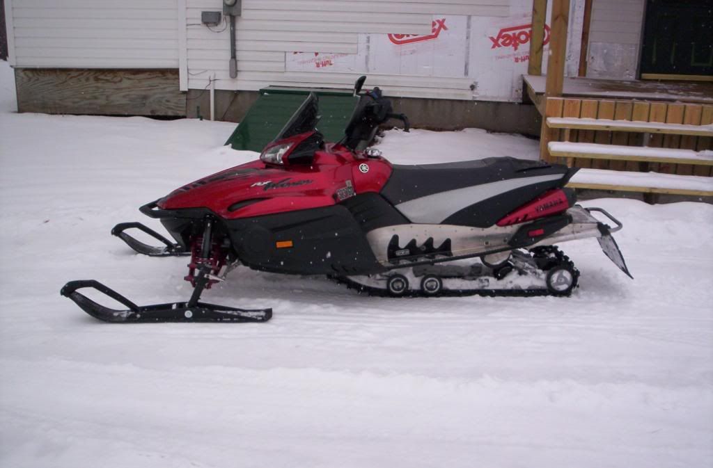

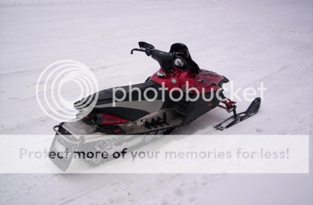

like 04rx10 said I have done this mod as well and have pics in the link in my sig. You jjust measure up the center of the cover 3 1/4-3 1/2" then measure out to the points on each side make an even line and cut put some kind of trim on it and put the seat on very easy and really worth it

heres a couple pics from when I cut my tank cover
the After
the After
