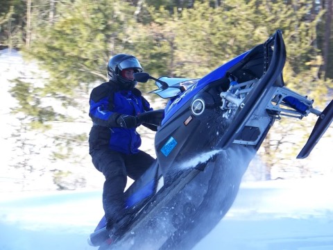

I rode my 05 RX1 with a lot of transfer. It was a wheelie machine and I really enjoyed riding it that way. It would pull the skis 6 inches at 50 mph and that was sitting on the seat in the normal position. I did not push the sled hard in the turns so no worries there. It is just how I enjoyed riding the sled and got very use to it. I now have an Arctic Cat Z1 Turbo rear skid in my sled. I did not set this skid up to wheelie and I have really enjoyed it so far. The skid launches hard with minimal ski lift. I guess it was time for a change.
