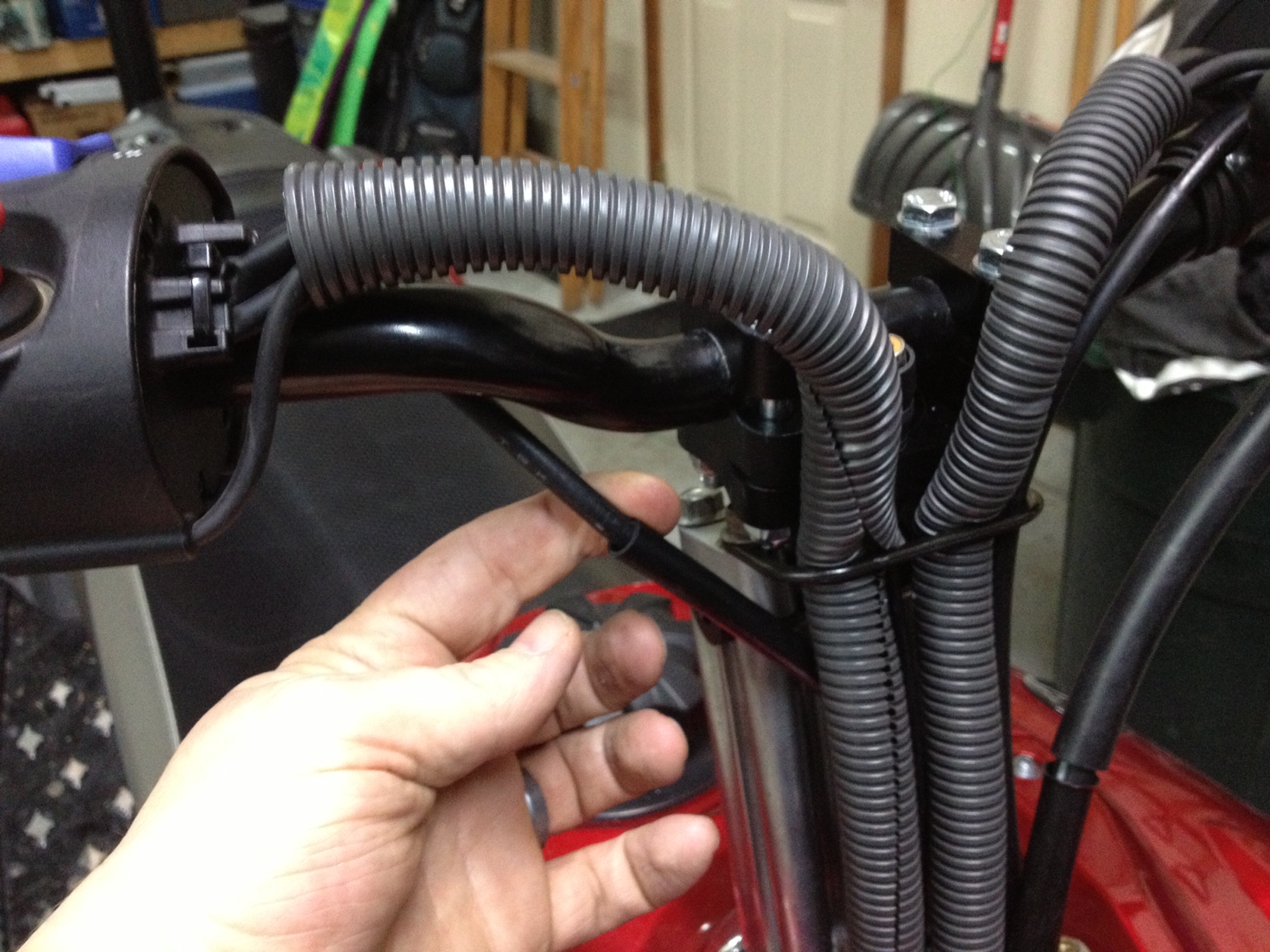

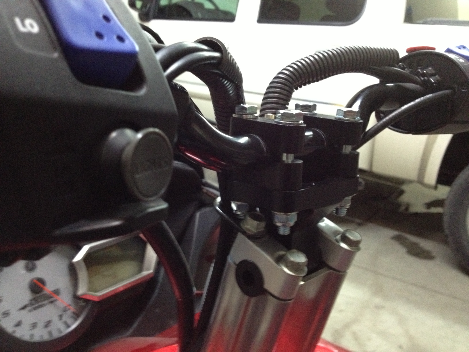

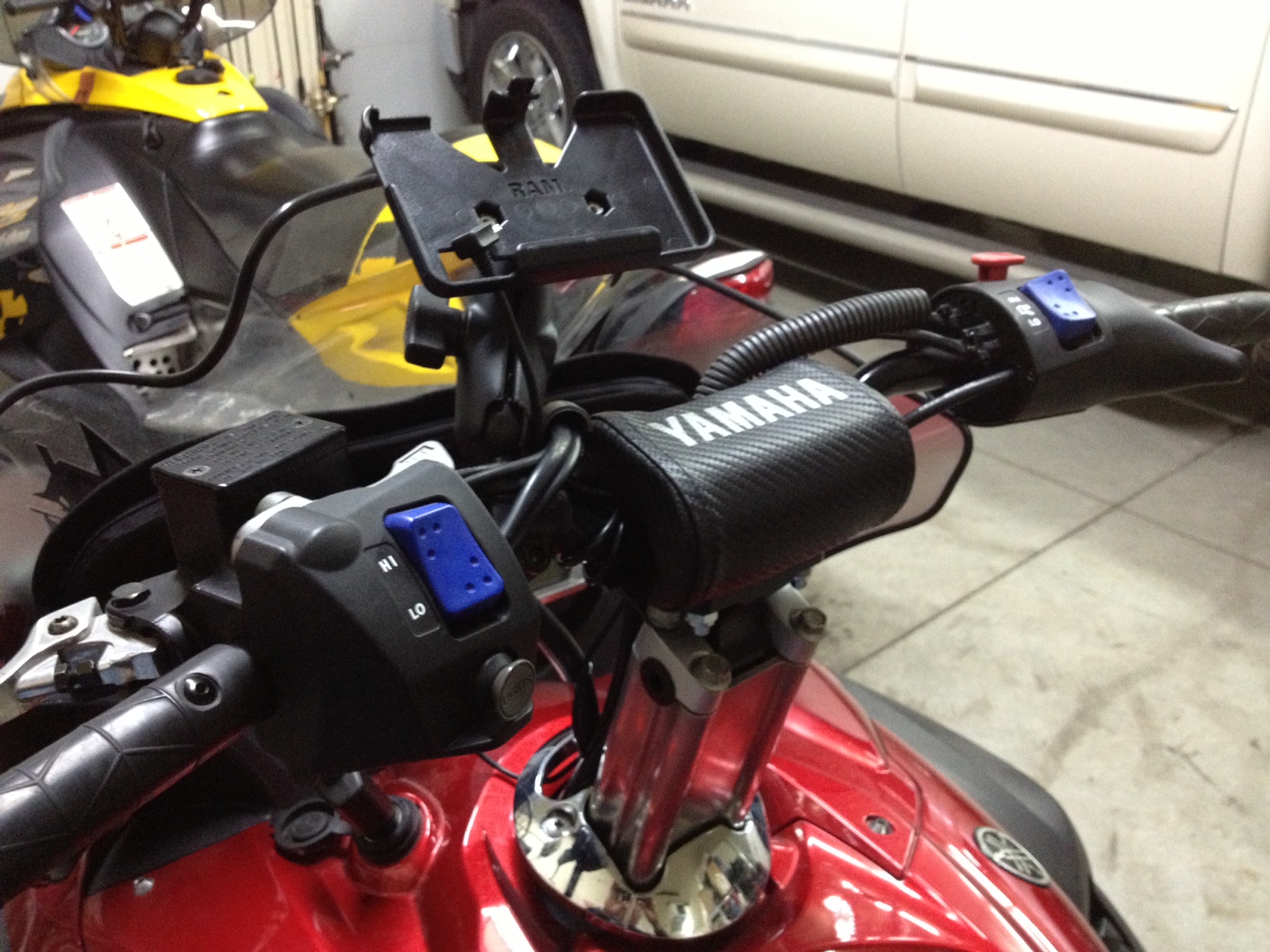

If you want to just add 2.5" and reach the limit of your cables, the PowerMadd Universal Pivot Adapter will do it. It allows you to keep the stock riser and cover the pivot adapter with the factory pad. (photo 5) All you have to do is pop the end of the throttle cable out of the fun flipper and re-route it under the bar. 5-min job on the re-route. (photo 3)
I have one on my Apex and one on my Phazer. My '07 Apex GT had the longer stock riser over the '06.
Good luck
Good luck

I went with Lake Effect 6" risers(Dog Bones) that I think he refers to them along with his pivot adapter, on my '13 Apex. Made a world of difference for comfort. I did re-route the throttle cable under the handlebar, but other than that no issues with over 3000 miles on her. I'm 6'1". Also when I did it I bought the Skinz wind guards, I believe their race versions, the smaller size which do not look overly burdensome on the sled. I never rode it w/o them to see if they are actually needed though, but I figured better same than sorry.

Thanks for the pics. I'm 6'0" and would definitely like to keep the stock pad, or I may put the sport handlebar bag on. Right now my arms are totally straight while standing. Maybe 2" is not enough. The mountain Apex Riser looks a lot higher.
