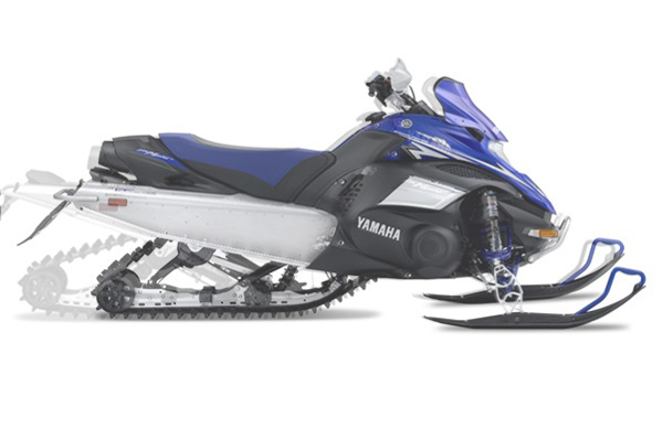

The "approach angle" will be determined by the extension forward of the swing arm mounting point, the radius of the curved section and swing arm length (driver size and drive shaft location is the same). The arc length of the curved section does not factor into to the equation - assuming it's long enough to be adequate for purpose.
Take a protractor with you too and get a number. Nothing kills a thread faster than a little objective data.

arteeex said:Below is the RTX superimposed over the XTX. Exactly how much difference is there in the approach angle between the two?
I know this is apples and oranges difference but it would be interesting to see the difference in approach angle compared to an artic cat 600 sno pro or even a polaris. I raced all season against these sleds and they were able to attack the rough stuff much better than I. I know that there alot of other contributing factors but I think the approach angle is part of it.
yamahabandit
Super Pic Arteeex. Love it! Wish I wasn't so computer challenged, I'd give it a try! Live up here in the wilderness, just got hi-speed 2mths ago. Years behind. LOL
yamahahaha
could it b possible to heat and bend the 121 rails to same angle as xtx railsand still b strong?

yamahahaha said:could it b possible to heat and bend the 121 rails to same angle as xtx railsand still b strong?
uh no!
you might be able to cut it back and install an anti stab wheel kit..

The only thing I have seen is Hartman inc. extension kit with "Slide Frame Relocation for deep snow and less trenching ", but i have not been able to find any detailed info about it.
http://www.t.kth.se/t00_bas/hartmaninc_Nytro.pdf

fastpig said:arteeex said:Below is the RTX superimposed over the XTX. Exactly how much difference is there in the approach angle between the two?
The IQ race chassis uses a pretty steep angle of attack. I'm not sure about the Cat. I know what you mean about those sleds ability to go through the bumps. The Cat riders sure look like they were riding with more control than I had when they passed me!
