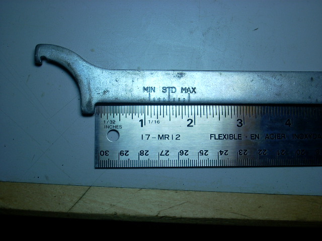

Will this do
I think the end with the hook gets bumped into the adjuster ring on the transfer rod. In other words add 1/4" or so to the measurement.
Great pics,though.

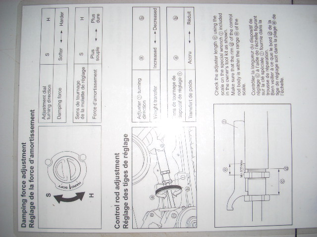

use this pic
I believe minimun setting to be 35 mm and maximun is 55 mm. Right from the suspension tuning manual.
