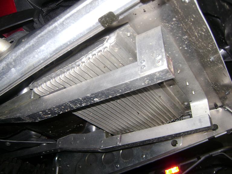

Here's a few pics from my installation. Between the actual installed heat exchanger and the fabricated protectors, I added a thin piece of slider material just in case there was some friction between the two.

Here's how I did mine, I don't run studs so I didn't bother extending protectors...this is a OEM from YAM.

thanks guys, they look great.
so the answer is yes, i have to cut back the stock tunnel protectors.
pictures helped alot, i will fab up some protectors.
