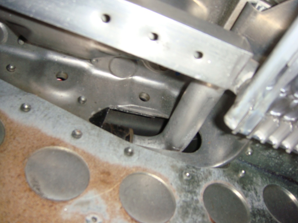

Here you go
Thanks for the pics. I see you cut off the protectors. I will need to keep them as I am running studs.

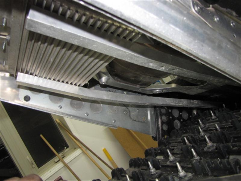

that how mine look no problem. I just went out and looked there is no mark from track hitting you are good to go have fun
