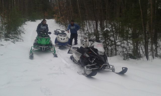

Hey everyone, new to the forum here and usually just absorb the knowledge and carry on but I'm in need of advice.
I'm 5' 7" 130lbs ( no gear ) and bought a bone stock leftover 2012 MTX 153 and I'm looking to give it some more control. I can toss a sled around and to be honest I've been more than impressed with the machine so far. Current shock setup is 60psi in the front, 85 in the front skid shock, and 70 in the rear. This is with the weight lifted. When I ride aggressive and don't need to be able to transfer weight in deep snow ( jumps, trails etc.. ) I bump the fronts to about 75, front skid shock to 100 and 90 in the rear.
I have not ridden it in anymore than 2 feet of snow so I can talk about deep snow yet ( early season, awaiting snow but would like a good setup if I'm going to have to trailer this year ) it lays over easy but seems very difficult to control. I will be doing the 37" a-arm kit next year but I'm watching my budget this season.
