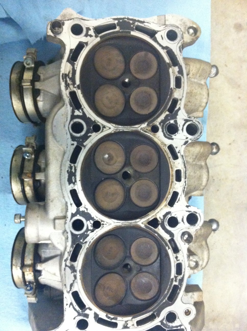

Picture of head
Well after all of my checks I decided to pull the head. Is the brown on the center cylinder signs of blow by or a problem? That is the only thing that looks abnormal to me.

Whoa.. What were your checks?
Hopefully there were several, and they would point you in the right direction. At this point you dove head first into it with your eyes closed it sounds like.
Blow by is more a term for loose rings where you are losing cylinder pressure into the crank case.
But in this case it *looks* like you were losing into the center water jackets.
Any compression in that cyl? If you were pushing coolant, (from the looks of that it would be quickly) and it looked dirty, then yeah - you've found your problem.. or the start of them anyways.

The head is warped in that area about .0035". It is within spec but i might resurface it anyway. All cylinders had 200 psi of compression before tear down.
There were also signs of oil in the coolant when all of this happened. The only thing that I did not verify was the oil cooler. Im not sure if I could pressure test that somehow or not.
I know someome who's been having the same problem. Compression was good and no warped head but he has a cracked water jacket from overtemps. Are you going to mill the head? Good luck.
