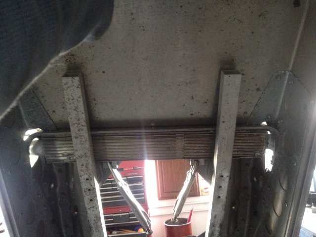

We have had great results with the 121 and 136 style coolers that we build in house, however when looking at numbers they are just not cost effective for us to continue building. We could up the price, but with the sleds that require them starting to age we feel the demand just won't be there. Still wanting to offer a rear cooler solution we have been working on a new design that utilizes the abundance of running board coolers we have on hand. The new design will also work on both a 121 and 136 sleds. By recycling used heat exchangers and designing one cooler for both models we will be able to offer a very affordable rear heat exchanger. Below is a photo of our prototype fit up on a 136 sled. It fits underneath the stock tunnel protectors, so like our current 136 cooler there will be no need to craft up your own tunnel protectors.

I think I pretty much got design finalized on these new coolers. My original prototype required that the rear tunnel protectors rivets be removed on the 136" sleds in order to get cooler in place. To remove them rivets required removing the muffler. Wanting an easier install I mocked up several different designs and finally came up with a solution.
The final design fits both a 121 and 136 sleds and slips into place right under the tunnel protectors. The installation is a breeze! There will be 4 rivets to secure it to the tunnel.
I can't put a bleeder in the factory location. I could install one in elbow. I a block of wood is placed under the left skis then that elbow would become the highest point in rear and would allow air to bleed. I however had a nytro in a few weeks ago with an aftermarket tunnel and cooler on it. There was no bleeder on it and I had no problems when I refilled the coolant system and am wandering if its really needed. I will likely install one just to be covered.
