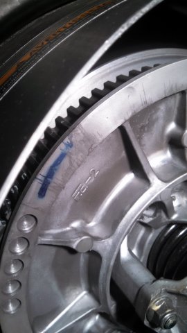

If you have stock belt it does not need to be above the sheaves.
rbell14
Yes. Stock belt. Manual says no more than 1.5mm above and no less than 0.5mm below the edge. I thought mine looked to be sitting too low in secondary.
You think its ok?
You think its ok?

By your picture I think its beyond adjustment. I would try a different belt. if its still that low you may have a clutch problem
rbell14
Thought it looked low to me. I can swap the belt with a spare and see where it's riding
Anyone else with stock riding this low?
Take the belt off and just set it in the clutch. I bet secondary is just not fully closed. If you dont want to do that try putting sled in reverse and then let it coast to a stop. See where it is then.

And if it is the 8jp stock belt it may be burned up, suggest switch to 8dn.
Looks pretty darn low. Clutch looks clean though. How many miles on it?
Put it on a track stand and roll the secondary slowly by hand. Then check deflection. Try to get a good picture of the belt between the sheaves when pressing with finger.
If it's loose start adding washers to the deflection screws and retest.

Thanks, Iwas able to roll it a bit an it did move upward in the sheaves this morning. Was short on time and will look it over more tonight.
rbell14
Took belt off and cleaned up clutches. Belt is sitting level with sheaves now. Looked like I had an issue but it's good to go.
