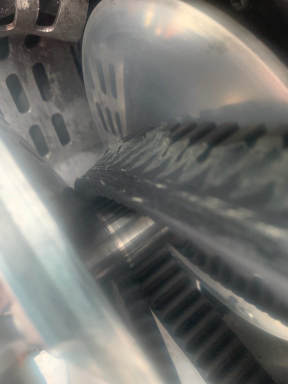

When revving on the stand, the track will grab cause of no lubrication which will make it seem like the secondary doesn't come back to normal. This is why when the throttle was bumped, the secondary would come back to normal.
As @jonlafon1 mentions...do not run your belt above the secondary sheaves as it will cause problems.
This was a sled that was giving me problems and he was ripping the top part of his belt off. (See pic) Now that the top of the belt is sitting flush with the top of the sheaves, no more issues.
