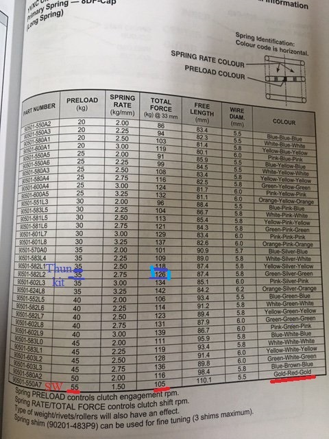

I like the black/blue Dalton primary spring. Its a 53/133kg and is roughly 12mm shorter then the stock primary spring, combined with glide washers.
The issue with stock spring IMO is its the LONGEST Yammie spring made on their chart, its 110.1 mm in total length, and I believe this has a TON to do with why it gets so distorted in the "very un-harmonic" triple clutch. Pair that with no glide washers and under compression it cannot help but distort.
Stock gold/red/gold primary spring is a 55/105kg. There are other shorter springs on the chart as you can see, and many of them will help with bind. It seems many of the "kit" tuners are using a low engagement spring around 35kg. They are combining them with weights with much more curve, and less overal weight. I tend to like the initial rpms higher with this sled, to get onto the boost sooner.
Gonna be fun season.
