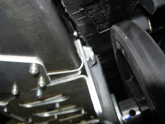

Yes, they'll rub with out modifcation. Also had to grind off 3 weld nuts on each side, and replace them with stainless carrige bolts facing outward.ult680 said:Mtnviper
How did the 16 wide go on? It looks to me like the rear drop down brackets will rub.
Also ground down the extra length on the rivits inside the tunnel, where the track runs. And replaced the rear bumper bolts, with round headed allen bolts.
Not a bad job to do. Just takes a bit of time with the cut off wheel!
