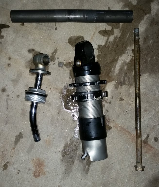

That's not blown that's ripped apart. What happened? New ones are $80 at Country Cat I believe. There is nothing left of that one. Call me.
viper strike
- Dec 22, 2016
- 168
- 34
- 73
- belle plaine mn
- 2015 yamaha sr viper ltx dx
Omg never seen one do that before.That's not blown that's ripped apart. What happened? New ones are $80 at Country Cat I believe. There is nothing left of that one. Call me.
Call country cat they will set you up.
Cheap fast and easy..
MartyV
- Mar 4, 2015
- 56
- 23
- 218
- Greenwood, ME
- 2015 Viper LTX SE
I just ordered a used 17 sidewinder shock and all hardware I need on ebay express shipped should be here by Thursday. I ride it hard, must have been the 10mile bumped up straight away on the way back to camp last weekend. Never seen a shock ripped apart like that tho.
Studroes stocker ripped apart just like that. Its possible the cap unscrewed. I know if I did it it was tight but they dont use a bleed in piston anymore so you have to do it from top. That means Loctite wont do a thing on the cap since oil needs to flow by . Its a bad design.I just ordered a used 17 sidewinder shock and all hardware I need on ebay express shipped should be here by Thursday. I ride it hard, must have been the 10mile bumped up straight away on the way back to camp last weekend. Never seen a shock ripped apart like that tho.
Also check your limiter straps. If in last hole you may need to go to the second since the straps stretch.
MartyV
- Mar 4, 2015
- 56
- 23
- 218
- Greenwood, ME
- 2015 Viper LTX SE
You did the shock rebuild for me but it has about 6000 miles on it since. Was hoping to make it through this season and send them back to you for a refresh.
It's possible straps stretched, I'll check it when I install new shock. Is the sidewinder shock better? How's the valving?
Valving was much better on 16+ Vipers and Sidewinders. Is the piston anywhere to be found!You did the shock rebuild for me but it has about 6000 miles on it since. Was hoping to make it through this season and send them back to you for a refresh.
MartyV
- Mar 4, 2015
- 56
- 23
- 218
- Greenwood, ME
- 2015 Viper LTX SE
Yes the piston is still in thereValving was much better on 16+ Vipers and Sidewinders. Is the piston anywhere to be found!
Save it. The valving might still be good.Yes the piston is still in there
