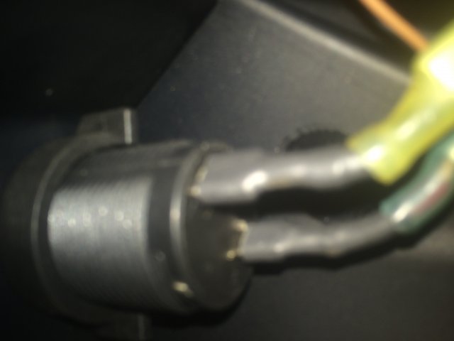

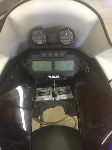

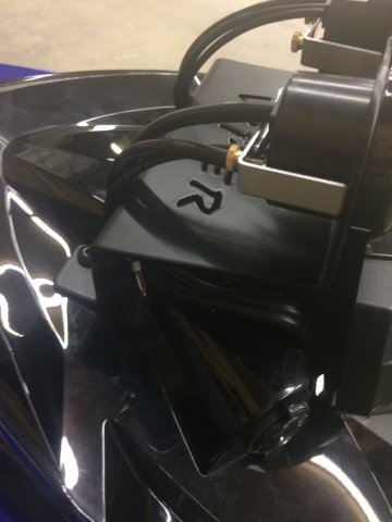

I really liked the reviews on the innovate afr and boost gauges they are a sealed marine gauge. Here is my set up with the osp mount. I have a hurricane turbo(should be same for mpi) I was able to do it without drilling holes for the wires too. There is holes to the left and right of the gauge and I put the wires down into where the top vent is. Then I led the wires from the exhaust and throttle bodies up with the stock Harness where you disconnect the hood. For power and ground I just taped into the cigaret lighter. With the innovates gauges there is quick disconnects so you can still remove the hood without taking out the gauges.

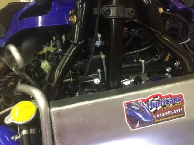

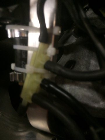

Can you take a pic of where you actually t into the intake for the boost " map sensor". Thanks man

I don't know what mpi uses but hurricane has a multi t fitting that goes to the bov, pcv, and a boost gauge if needed. Someone with a mpi turbo should respond where exactly they put there's because I'm not sure for there's.
Above the intake is where I put the sensor for the boost gauge just make sure the fitting is facing down and that huge connector is for the innovate afr sensor
Sent from my iPhone
I just "T" 'd into the gems controller vacuum / boost hose line coming off the top of the turbo like he showed in the pic. the sensor unit on mine and the connection for the AFR gauge is in the trough under the plastic screen in front of the handle bars.
