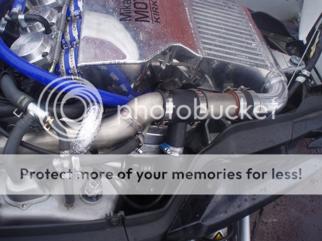

A little "heads up" when using the Bosch bov:
If you look at the Polaris fst turbo 4 stroke. Their black silicone T- adapter for the Bosch bov fits perfect on the Bender charge tube. This saves you the hazzel of having a 25mm nippel welded to the charge tube
But install it before pitot jet and vacum hoses t'eed together
Picture is just to show you the t-adapter.
