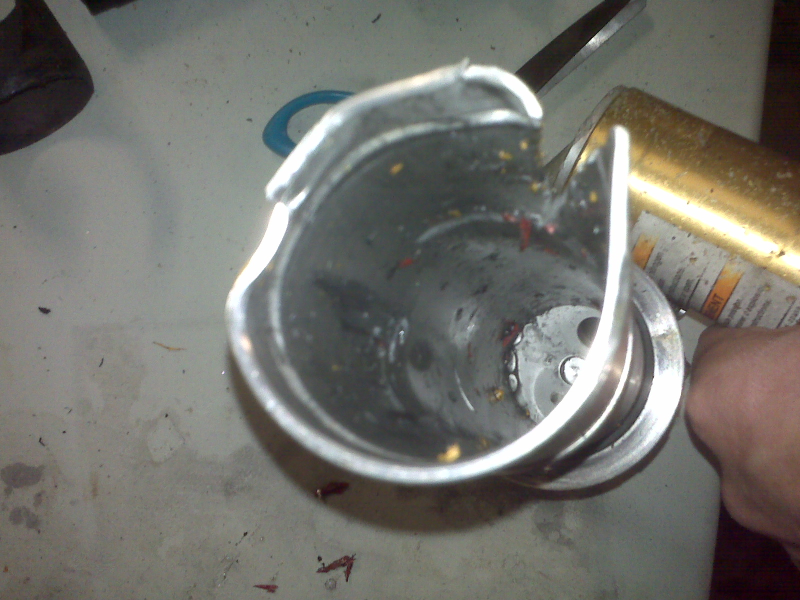

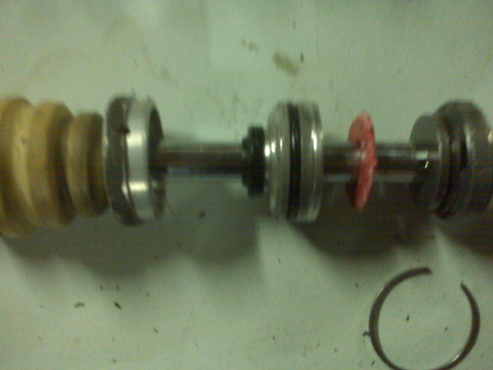

Well here are some pictures of the shock now. looks like the only main damage was to the shock body. The shaft is still straight. Who wants to fix this up for me?!?!?!

sledneck22 said:Well here are some pictures of the shock now. looks like the only main damage was to the shock body. The shaft is still straight. Who wants to fix this up for me?!?!?!
If you find an ER shock, have Pioneer revalve it - my buddies works real nice. Of course you'd have to cut a hole in your tunnel for the adjuster.
I'd get the BJowett PDS upgrade if money is not a concern. I would love ride one with that getup.
I had Pioneer revalve mine this year and it works much better than stock, if you don't want to pop for the PDS I'd go that route.
You a longtime Sparta resident? My bro lived there and was a teacher at Melrose Mindoro (I think that's what it was called) for years (died in 2004.)

Re: shock disassembly
Call Brain Jowett and talk to him. He can get you about any progressive stack valving you want. Or give him your sled, weight and riding style and he wil taylor a valve stck to match. Obviously Pioneer and Carver arealso very good and any of the 3 will fix that shock.
But since the shock will be out for a week anyways, I'd also have the Progressive Dampening System installed on the shock.
It's the real deal.
sledneck22 said:....... looks like the only main damage was to the shock body. The shaft is still straight. Who wants to fix this up for me?!?!?!
It's the real deal.

you can also send the shock to carver performance they are close to you and they will fix it and revalve it

darv said:you can also send the shock to carver performance they are close to you and they will fix it and revalve it
Yep, he is also a Ohlins Guru.

Found a shock from a fellow TYer out of a 2009 I am going to buy. I am thinking that the shaft might also have to be replaced on my busted one because there are a few little scratches down on the bottom near the piston. So I don't want to chance the seal wearing out right away.
