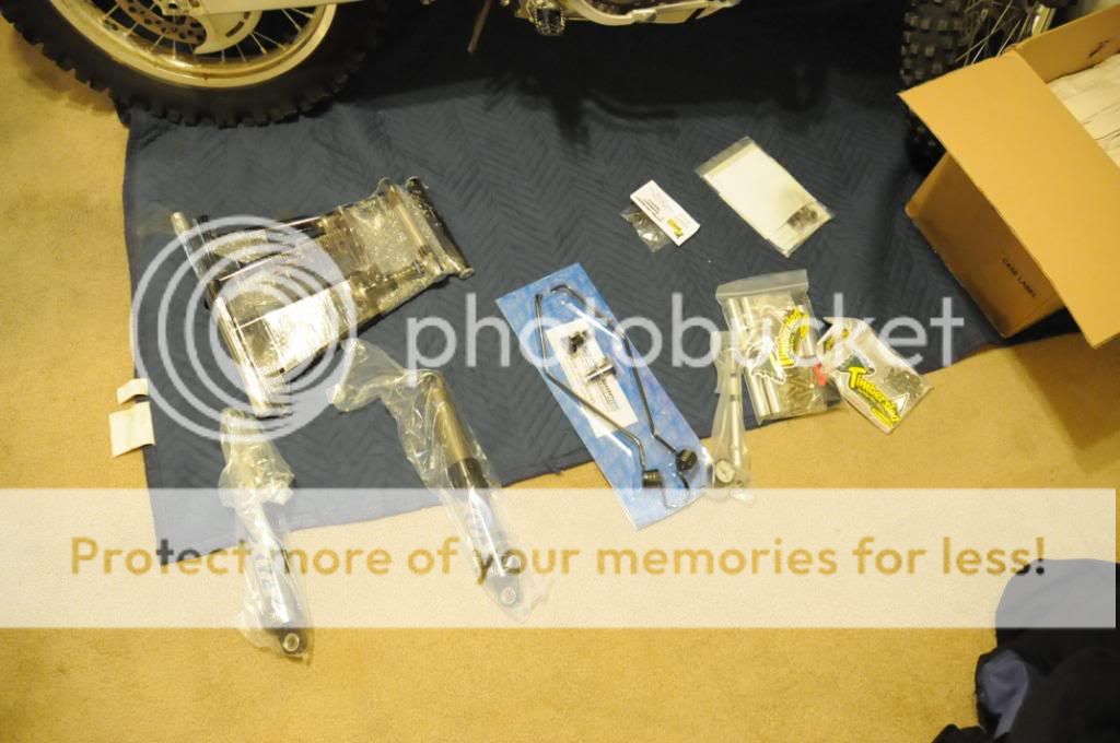

Timbersled kit waiting to be installed
reverse kit waiting to be installed.
yeah yeah, i know. It looks like every other cardboard box you have seen. But this is a magical box and will make my sled go backwards.

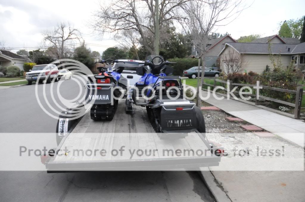

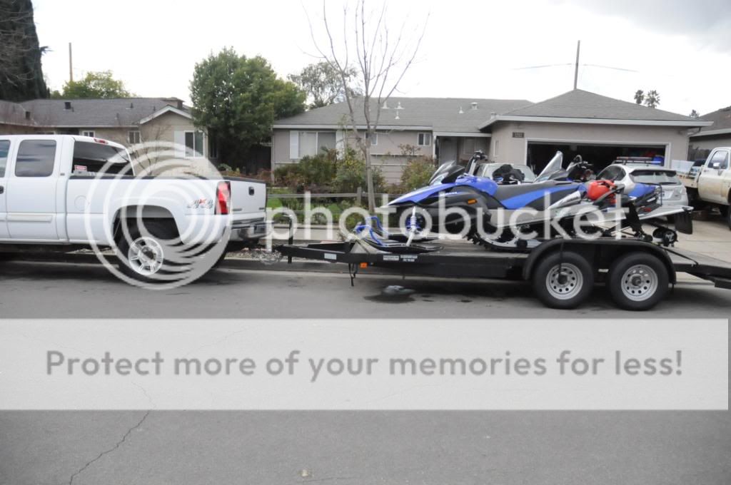

And i bought a trailer a while back. Its a flatbed 18' rated at 5k lbs, even has axle brakes!
I used it a couple of times when my girlfriend and i went sledding but it had some drawbacks.
I need more tie down points.
I need to install the spiffy quick tiedown bracket thingies that grab the ski's. Tie-down straps suck once frozen.
I need to install some sort of blast shield on the front. I always keep em covered, but reducing the shotgun effect of road trash would be nice.
the carbides were cutting into the wood deck and splintering it.

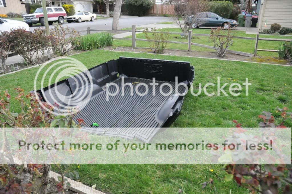

Its a bedliner for a long bed Dodge and the guy wanted $20. I didnt bother haggling and handed him a $20 with a smile on my face. He was a bit confused though, i showed up in a shortbed chevy.
I cut it into strips about 8" wide and screwed them to the deck on the trailer. (unfortunately i didnt snap any pics of the final product) So there is a strip along the left and right side, plus one that runs right up the middle for the sleds to share with one ski in front of the other.
the cool thing about the bed liner is its really slippery and the ski's glide effortlessly on it, the carbide is not touching plastic at all so its plastic on plastic. Also the strips dont get in the way if i want to load cars on it. Just drive right on like its not even there!
