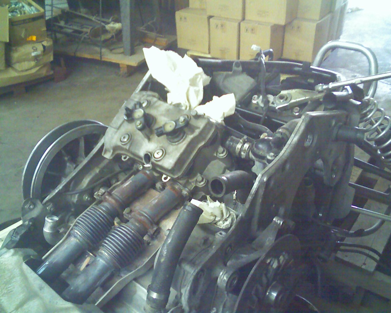

It has been a while since I have posted anything on this link but here it goes.
Our team has acquired an engine and we are in the midst of rebuilding it.
Any questions or concerns, please don't hesitate to email me.
