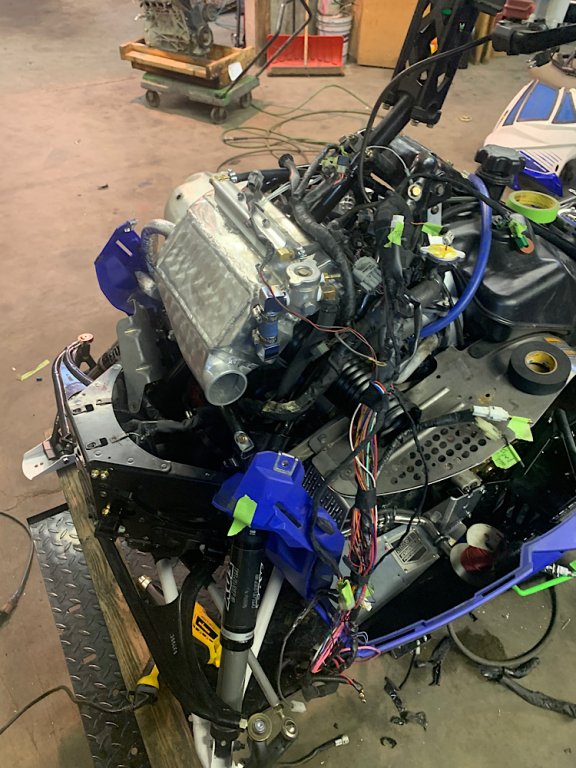

Intercooler mounting tabs done. Using a pump from Mercedes to circulate the intercooler coolant.

Started installing the Nytro harness into the Sidewinder chassis. Extended to reach the Hurricane upgraded fuel pump in the tank. Shortened here and there. Modified to run the intercooler pump, the Snow water meth controller, the Boost-it AIC, the Boondocker EBC, and the Dobek Gen4 AFR controller. Antigravity battery and freeze proof relays installed as well. Battery is in the nose.

Mocking up the intercooler plumbing. Tial BOV. Some heat shielding installed. Cold air intake tubing installed under intercooler.

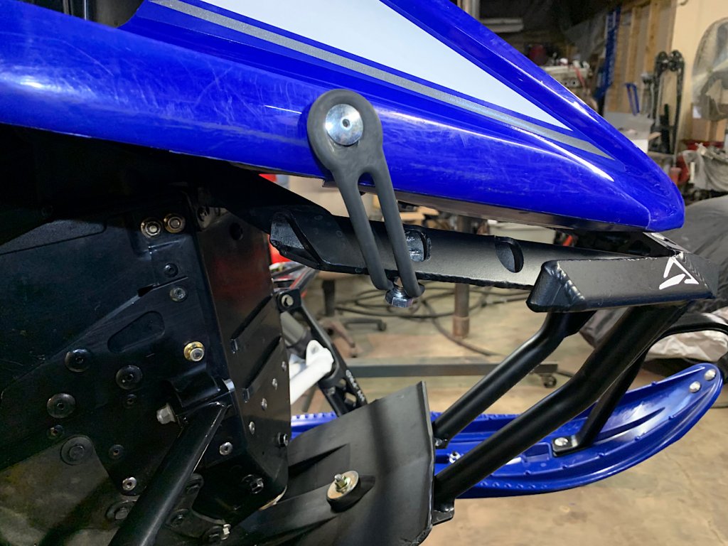

Here’s some misc. pics. Munster finger throttle. ARC levers. Mohawk skis. Snow flap. CR racing hood. Skinz bumper

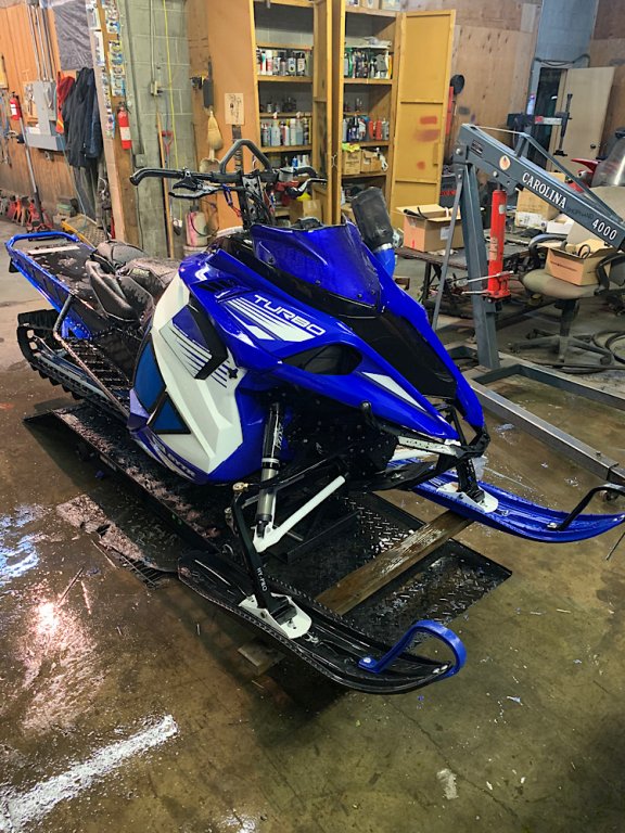

This is full of fuel, coolant, oil, 2 spare belts, tools, etc. ready to ride. Weight wasn’t the main goal with this build. Durability played a slightly higher role. I know I can install a lighter muffler, some tubing can be made lighter, couple pounds here and there.

Ridden a few times. Not sold on the Mohawk skis yet. Boost set at 10lbs while I sort everything out. So far it is very impressive. The combo of the turbo and stock compression is spot on. Instant response. AFRs have been dialed in nicely. Need to rebuild my Tapp before I finalize clutching. Had a bad ignition coil the first time out so that trip was null. Rides very nice. More to come
