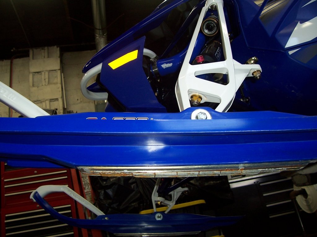

Not sure what model C&A you have but yes most of them do steer hard. They turn on a dime and don't seem to dart. Probably why the snocross racers really like them.
I ran them back on one of my 2 stroke Yamaha's, worked great in the UP of Michigan with the sugar snow that does not pack. Down in Southern Minnesota the snow is different and I found them very hard to steer.
A buddy had a set that came on his supercharged 2006 Attak. Loved how they turned and never darted but they did wear you out. He had an idea and gave them to me to take to work and I had my machinist buddy mill down about 1/2" off the bottom of the keel. As seen in the above photo C & A tends to use a very deep keel. That made a world of difference, still had all the good traits but did not wear you out as bad.
Just thought I'd share that.
