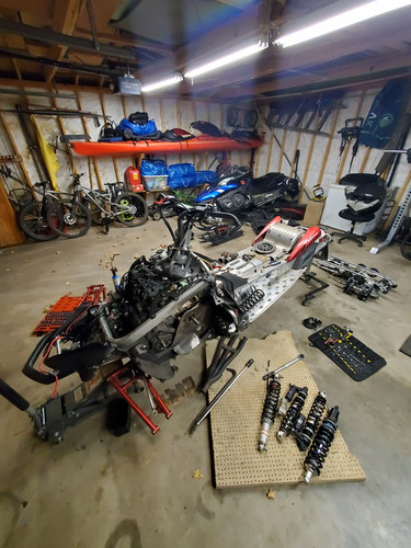

Hello!
Thanks again for this amazing forum. I bought a pristine 2012 Apex XTX this week and have my Vector LTX stripped down for some maintenance at over 17k miles.
1. What is the best way to change out the extrovert drivers on a 2010 Vector LTX? I am about 1mm above the wear limit and have the sled torn down, so I am thinking I should just change them.
2. I have a 3" riser and the Powermadd cable is just too long. I left it last year but it looks janky. Thoughts on the best OEM cable to buy?
Stock is 8JA-26311-00-00
2013 Vector uses 8HV-26311-00-00
2010 Nytro MTX uses 8HA-26311-00-00
Apex MTX uses 8FS-26311-00-00
Venture uses 8HF-26311-00-00
3. I have changed and grease my speedo and secondary bearings, but I haven't touched the bearing behind my primary. Should this be greased like the others? Changed?
