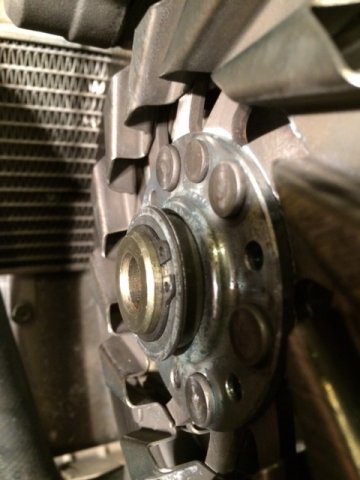

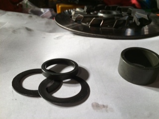

Collar goes behind the rotor and the washers on the outside.

That diagram is difficult to see. I have a c clip, two washers, and a spacer in front of the rotor. The coller with the set screws is behind it. Is this correct?

Based on your info I it looks great! Its the small spacer behind the washers that make you wonder!
Collar, washer, washer and circlip. Just have to click on the magnifying glass icon in the corner.
The collar with the set screws goes into the seal of the chain case.
I usually take pics as I tear something apart. Helps to take some of the guess work out.
Me too! Meant to do all this in one day and had it layed out perfect. Who knew I needed a perfect 36 mm deep socket to get the bolt off the shaft. Took me a couple weeks to reset on that one and finally found one! Thanks for your help! Got it on perfect.
