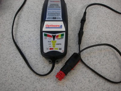

I re-wired my 12V socket direct to my battery with an inline fuse so that I can use my GPS with the engine off. This allows me to use the Optimate cig. lighter socket attachment to charge my battery.
Very slick.
Very slick.
Wanna do mine - I'm only about 350 miles away probably.

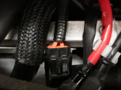

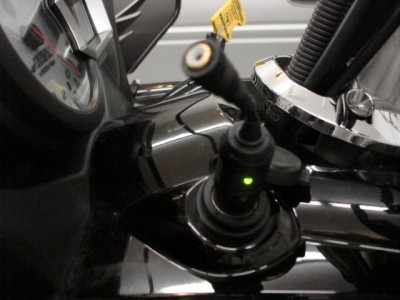

Bring your sled over and I will take care of you! Seriously it is very easy and you can do it yourself if you have some basic electrical skills. Your local Radio Shack or any auto parts store should have what you need.
As you can see in the pictures I cut the wires to the stock accessory socket connector and I spliced on a two piece polarized connector. The other side of the connector is wired directly to the battery with an inline fuse on the positive wire. I always solder and heat shrink all of my electrical splices. I also could have cut the wires on the other side of the stock connector and used both halves of the stock connector but I wanted to add some extra length to make it easier to remove this panel. In line fuses hidden under the air box are a PIA to change so as you can see in the pictures I wired my inline fuse connector so that it is easily accessed by simply removing the right side panel.
Having the accessory socket hot all of the time (rather than only when the engine is running) is nice for using GPS or cell phone chargers while the sled is shut off. Before I added GPS to my sled I used to plug my heated shield into the accessory socket with an adapter as shown in the pictures. Having the accessory socket hot all of the time allowed me to keep my helmet shield hot and defrosted during trail stops. I have since wired in a dedicated always hot RCA jack connector for my heated shield.
