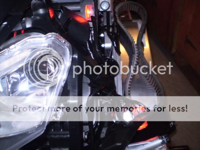

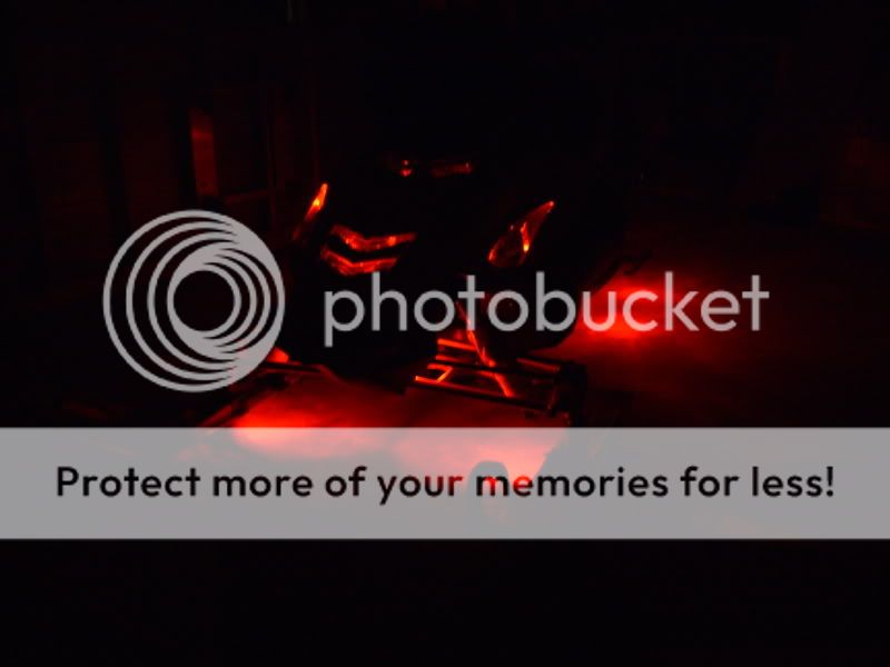

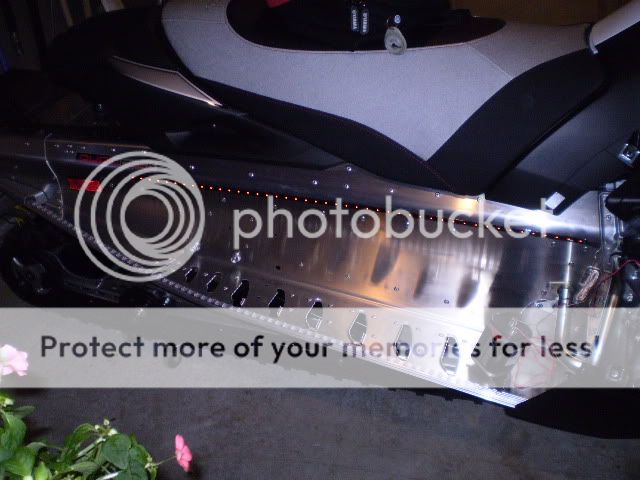

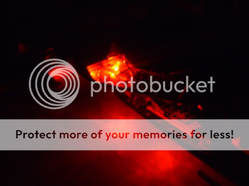

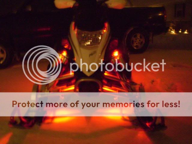

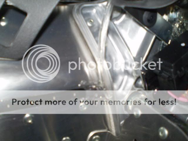

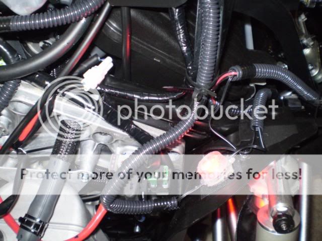

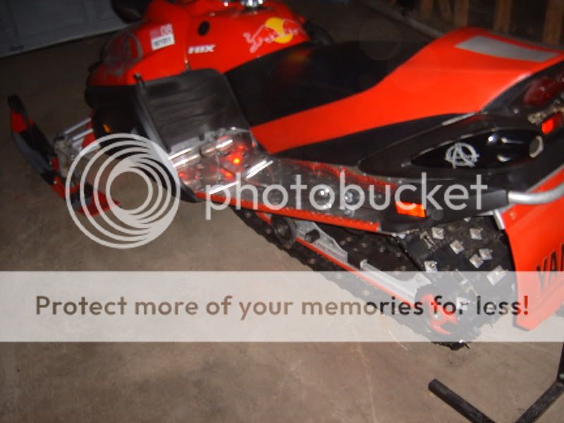

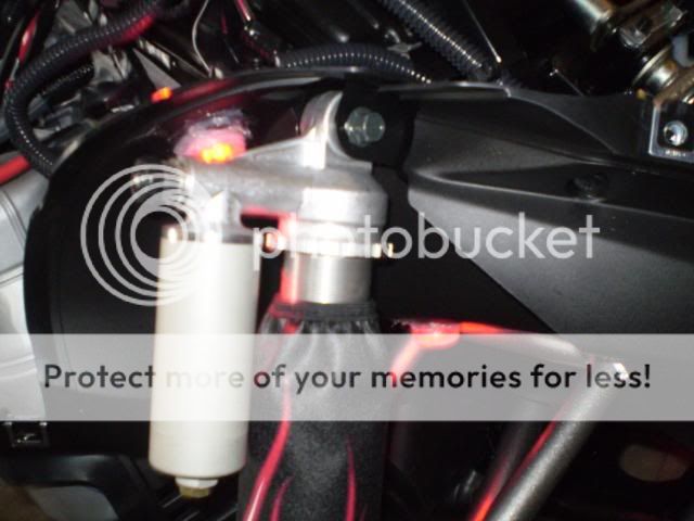

Well after lots of trips back and forth to the store I finally finished my lights last week. What a pain in the azz! 20 ga wire is not fun stripping and the tight confines of the Nytro made it even harder. I ended up using 15 ft of split loom and 6ft of clear pvc to protect the wires.
I decided on 2 pods per side on the shock area and 2 pods per side in the engine compartment. Wired in extra wire between pods so if the bottom panels have to come off should be able to pull the wire thru rubber grommets that I installed. May have to install some quick connects of some sort to make it easier.
The lights in the inside I used adhesive back velcro so you can just pull them up when you need to remove the panels it also easier to reposition them to get the best light. I've gotten real good at taken the panels on and off during this install
Then decided to put the light strips on the tunnel becasuse it looked easier (LOL) and didn't want to deal with snowbuild up, plus the tunnel is long and straight. I ran those wires thru the clear pvc alonside the fuel tank into the engine bay.

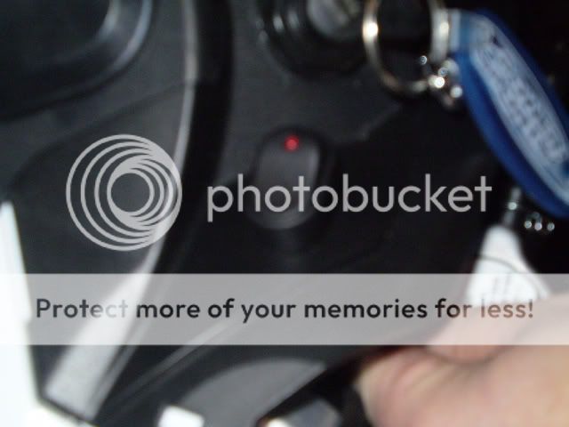

Added rocker switch under the key ran wires to the battery with a fuse.
Heres some pictures from the install. Enjoy
