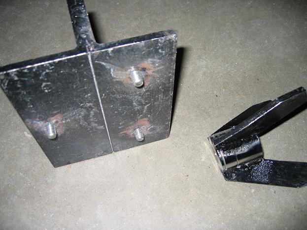

..did the o-ring kit but the noise comes back after a while; just as with new buttons. I came up to agree that shimming before & at middle season is the only way to keep me happy. I made my own tool and use either bud can, pepsi can or whatever thickness can fit underneat the buttons.
Consist of a base that i secure in the vise on which the clutch fits the 3 prong. Clutch can be secured with strap if need be.. i don't.
The other part is a 1" (i think) box tool from 1/2" set with 3 hard steal welded leg that fits in the clutch arm. The box must be big enought so to fit onto the shaft for stability. What you do not see it the 1/2" ratchet + 3' pipe required to loosen the clutch. (clockwise please... that is reverse way)
To screw back on, i use a torque wrench.
Picture here:
http://www.ty4stroke.com/download.php?id=47413
Picture here:
Thanks for the info
Thanks for the info that will be a great tool to keep on hand. Great photo as well.
