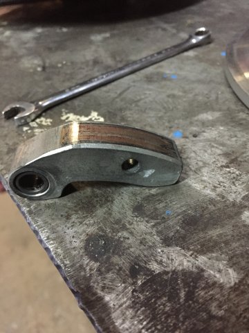

I would love to get a Evo flash, but at this time just cannot afford to. Although Raising the limiter would make sense in my problem. Here is the weight I'm running it also has a slight bump at the heel. Would a slight sanding help that over rev of the hop?

Takes more than a light sanding, but yes that bump is designed to create a higher rev at take off. You might ask why would anybody design a weight like that for a torque engine and the only answer I might guess is that they are used to 2 stroke engines. Yamaha designed a weight especially for 4 stroke engines called 8FS that the entire ramp is flat. So 4 stroke weight profiles are not new. The heart of the COTC is a flat profile 8FP (similar to 8FS but half the price)
That being said I ground the bump off my Dalton QAY 70 and now it does what I want. As with any mod there are risks - do not do - ETC for disclaimer. The pic below shows the 8GL that I ground the bump off the heel and tested, stopped the take off over rev but I wanted a flatter profile and went with OSP Viper weights for our red viper. Not telling you too (see disclaimer) but if it was me I would grind that bump off the heel to make a matching ramp all the way up, and set side by side to get angle same on all 3 and weight to get same weight. Or buy OSP viper weights that the weight is set with magnets

Do you know how much weight can be loaded into the OSP weights? Doesn't say on their site just stresses that it's a low boost turbo weight.Takes more than a light sanding, but yes that bump is designed to create a higher rev at take off. You might ask why would anybody design a weight like that for a torque engine and the only answer I might guess is that they are used to 2 stroke engines. Yamaha designed a weight especially for 4 stroke engines called 8FS that the entire ramp is flat. So 4 stroke weight profiles are not new. The heart of the COTC is a flat profile 8FP (similar to 8FS but half the price)
