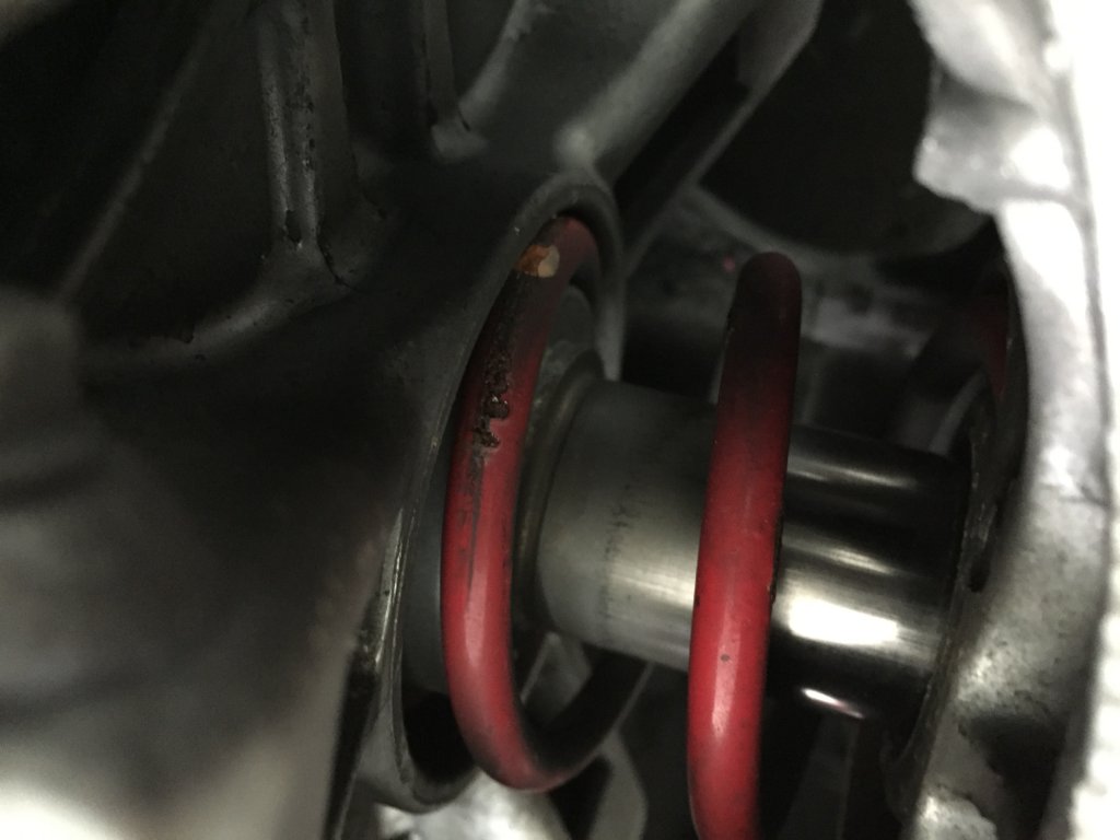

This is what is on there currently.
Stock helix. primary clutch spring is not stock. Clutches look dirty, blowing compressed air will give you better performance. I'm parting with my dragon fly kit if interested.
I have the cover off the primary, got a clutch puller coming this thursday. After i get the clutch off how do you get it apart? Do you have to use the expensive Yamaha tool?
First off I am no expert. I have fiddled with my set up allot this last year trying to dial in a super charger. First of all why do you want to take apart the spider is it sticking? there is a bushing in there that can be replaced but it is usually good for a long time. all of your cleaning and adjusting would be done with the front cover off and you could pull the whole clutch off the motor and throw it in the dishwasher(just don't tell the wife). all adjustments would be made in the weights (the three arms) they have rivets in them of different weights. and each one has three and each weight has an effect on different parts of your power curve but the over all weight also effects where your final rpm will be as well. if you replace the stock weights with adjustable aftermarket ones it makes fine tuning easier. Be sure to use medium strength lock tight on all bolts. the spring will adjust how easy or hard the clutch engages and also effect how fast it shifts out. the secondary(also put in dishwasher) has a helix and a spring. The helix has an exact angle ground into it and finished smooth as glass do not knick that part up as it will wear out your buttons that ride on the ramps. you can get helixes of different angels and even multi-angle as well this effects how hard it is for the secondary to be opened by the belt getting shorter from the primary closing has a big effect on mid range rpm and final top end rpm as well. and then you have the secondary spring its tension will effect how easy/hard it is to open secondary as well and the number settings you will find every hole the spring can go in on the clutch and the helix will have a number so if some one tells you to try 3-1 you would put on side of the spring in the 1 hole and the other in the 3 hole. this effects hoe tight the spring is wrapped when installed this will adjust top end rpm because of the resistance it take to open secondary and also effect backshift(how fast the secondary will close back up when you let off the throttle. too much back shift and it will put you over the bars not enough and the belt may slip when on the throttle then off and back on again fast. it is truly a symphony going on in there and there are so many variables to play with that unless you have lots of time to play with it you are best to get a basic set up from someone with similar set up and tweak from there. also only make one change at a time or you wont know what did what when fine tuning. every thing you change can effect every other part of the system.

Thanks for the info! Yeah the spider was sticking, got it apart and cleaned everything behind it. It moves nice now, the dealer thought everything looked good still. Waiting to hear from Ulmer, wanting to get one of his kits. It had a EPI spring and weights in primary, stock secondary helix and white attack spring.
