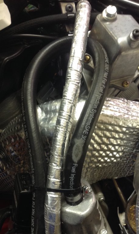

Just installed Rockerdans ROV mod today allittle tight with 5/8" fuel line, cleaned yellow milk out turbo tube. Plugged off bottom line, but left small line from air box alone, will this be ok?

Where did you find the plug for the intake hose?View attachment 145157 View attachment 145158 This needs to be plugged on intake , and the vent line off oil tank needs to be unobstructed out to running board

I cut the 5/8" hose going into the turbo pipe under air box and left it about 4" long and plugged hose with a large bolt and clamped it, I cleaned out oil and moisture out of short hose before plugging it. I have not plugged off small line going into air box yet!
