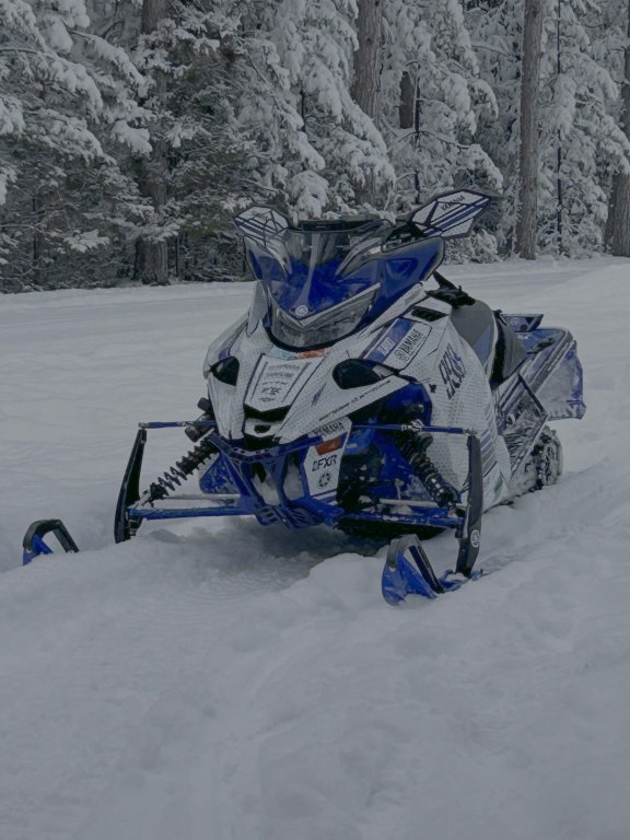

Sharing my settings on my '25 XTX LE to see if it helps as I absolutely love my XTX and the handling. I enjoy the fun factor and the comfort of the rear end suspension compared to my '23 LTX LE. I don't ride my LTX LE any more as I just love the XTX. We have a ton tight twisties here in Northern WI and the sled just feels dialed in.
Rear:
- Adjuster block at 2
- Fox iQS set at Medium
Center Shock:
- Fox Kashima QS3 set at 2
- Dual Rate Springs 140#/250#
- Spring Preload - 1 turn from loose
- Limiter Strap at stock
Front Shocks:
- Fox Kashima QS3R's with iQS set at Medium
- Elka Dual Rate Springs 527#/150# (9.4x45 / F2.7x254)
Skis:
- C&A Pro XPT
- Carbide: SnowStuds Triple Downs
Track:
Ice Arrowhead 130

I would like to see the angle your front a-arms at rest. Level? Upward? Downward?Sharing my settings on my '25 XTX LE to see if it helps as I absolutely love my XTX and the handling. I enjoy the fun factor and the comfort of the rear end suspension compared to my '23 LTX LE. I don't ride my LTX LE any more as I just love the XTX. We have a ton tight twisties here in Northern WI and the sled just feels dialed in.

My sled is up at the cabin, but let me see if I have any pictures from this year that show the front a-arms. Stay tuned as I look.I would like to see the angle your front a-arms at rest. Level? Upward? Downward?

Stain, here a a few different pictures I have from different angles, so hopefully you can get an idea. I think when I sit on my sled the a-arms are parallel to the ground.
