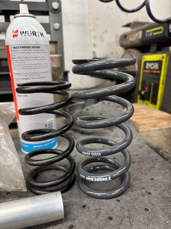

The setup on my front track shock is the same dual rate spring setup found on the RR's.
Part #'s: 3704-035 (140#) and 3704-039 (250#)
Do you have dual rate springs on your FTS? If so, what are they?

I do have a dual spring set up on the Elka FTS, I will have to look at the specs. I may need to soften one or both of those springs.

Looking through my notes to see what I have on my FTS for springs on my Elka Stage 5's that are on my other LTX 137".
Elka Stage 5 FTS: F4.0X52 Tender / F4.0X152 = 224 lbs/in (On my 137")
I really like the dual rate spring combo that is on my XTX with the RR springs at 140/250.
