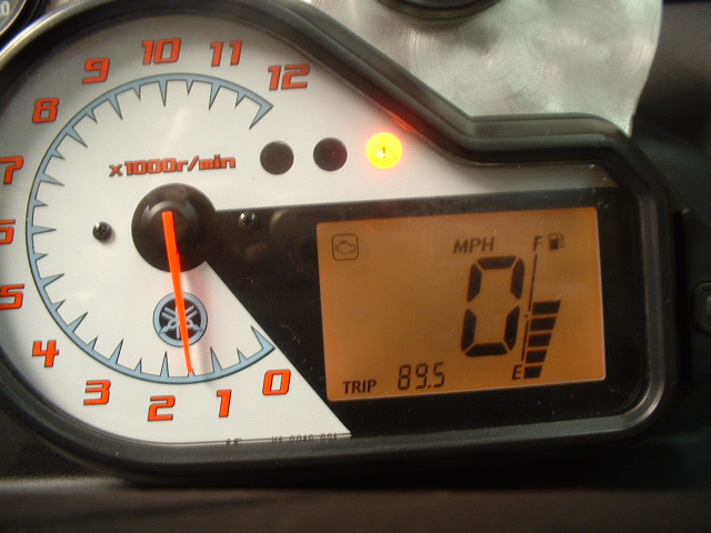

I am having fits trying to figure out what's going on here with my Diagnostic lights. Here's the scenario:
* I checked my oil cold.....Showed low, about 1/2 way between marks
* I warmed it up good and checked it again and it shows over-full.
* My dash light is flashing
2 Long....1 Short with orange light and engine symbol (See Picture)
The manual doesn't say what these codes mean, or at least not in plain English. Anyone have any ideas?

RX-1 Moose
Did you mess around with your Handle Bars? If your hand warmers are not plugged in right it will cause problems. 1 wire plugs to the other warmer and one wire from each warmer goes to the sled. I got mine from the dealer and they had the warmers plugged into one another and the engine light was on flashing codes, the dealer could not figure it out. I plugged them in right and everthing was ok. I was lucky and found the problem right away. I do not remember what the flashing code was but take a look.

I had the carb rack off to set the idle screws, but that's it. I think Yamaha did a very poor job on the manualas far as being able to diagnose the problem by reading the dash lights.
spray25
2 long and 1 short is the TPS being unplugged.
Page 8-47 of '03 service manual.

I started checking wires after work today and found that one of the wires on the 3 prong plug that runs to the PTO side TPS had pulled out of the socket. It wouldn't stay in with the little plastic retaining clip, so I super glued the one wire. The light is out now. I think it may have been loose for a while as I've had that light before and it went away.
Thanks again for the help, Spray you hit the nail on the head bud.
