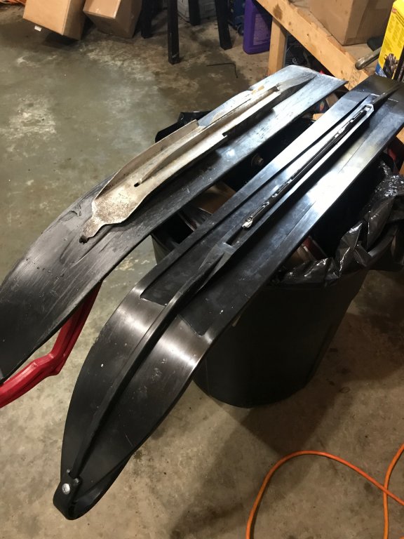

Through February I put on about 1000miles in Quebec and Northern Ontario with all sorts of trails and conditions and wanted to follow up. Thanks for all for the responses and links to other write-ups on viper suspension setup. Like islandracing mentioned, words like "push", "darting", and "on rails" are way to subjective to be taken as literally. Especially when rider weight and trail conditions play important parts as well. On typical days my machine "railed" turns at 35MPH but blew them at anything above 50... The best way to confirm your sled is handling like crap (besides this forum) is to trade with your riding buddies (particularly those on the same chassis) for a little bit. It really helped alot to determine how to get the most out of my '14 viper LTX-DX. People who rode my sled said it was pleasure to drive (zero turning effort) until you try to go fast with it. Then it was terrifying as you blow through turn after turn on hill crests. In the end I had the limiter tightened to the 4/5 hole, the center shock rattling loose and ski springs full preload. All this and being on top of the bars allowed me to keep up with most of the riders in my group. But boy was I pooped at the end of the day!
Fast forward to last night. Went down to Royal to buy a pair of Snowtracker aggressives, but no stock. On their recommendation I picked up a set of Slydog trail skis (1" fancy keel ski with a 6" carbide, incl mounting kit). Almost the same price for the whole set as the ST carbides. Installed them. backed of the ski preload to half, brought the limiter to 2/5, snugged up the center preload 3/4" and went for a rip. Holy crap. I could tell things were different as I could now feel the trail underneath, and there was some mild darting. One fast tight turn in and I new I had it! No push. The ski dug in and I was in business. Can't wait for the group ride this weekend!

It went great! So far I really like the Slydog setup with the 6" carbide. I have not experienced any push which makes sense when you look at how long (and deep) the keel is on the ski (it runs the whole length of the ski). I am still dialing out the darting by adding preload to the front skid spring. I must admit, the 2014 Yami ski with semi snowtracker had zero darting and almost zero turning effort. It just didnt grab at speed, which makes sense since they make an aggressive ST version for that. So if you are not an aggressive rider, you would likely love my old setup. If you are an aggressive rider, buy the aggressive ST or get a more aggressive ski design like the Slydog.
