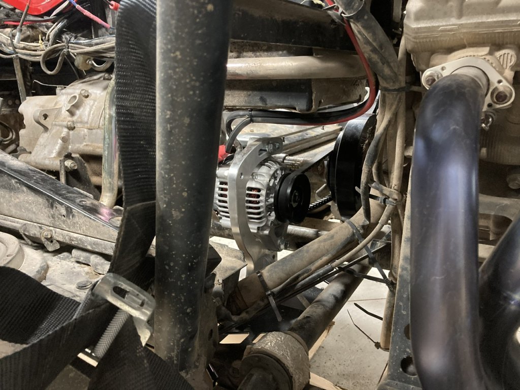

First and foremost I wanted to clean up the wiring mess by the battery. I added some distributions posts, 2nd battery and a DLP alternator kit.

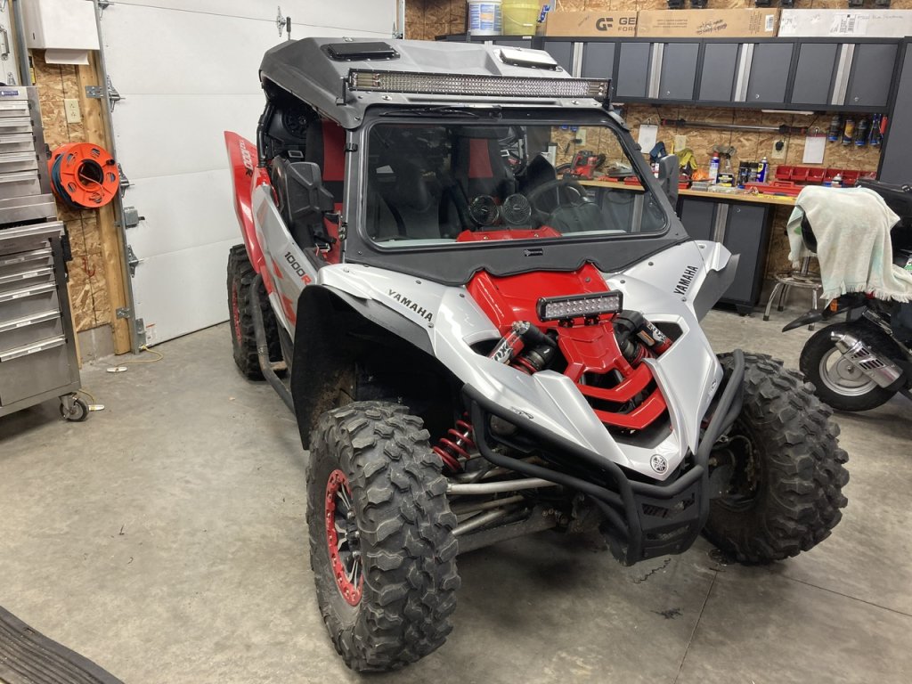

I was tired of the scratches in the plastic windshield so I added a Bent Metal windshield and a rear wiper from a 2005 Ford Escape.

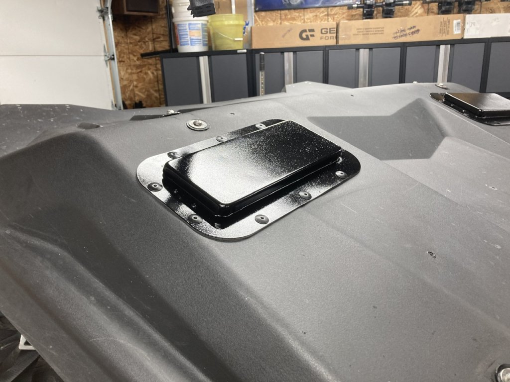

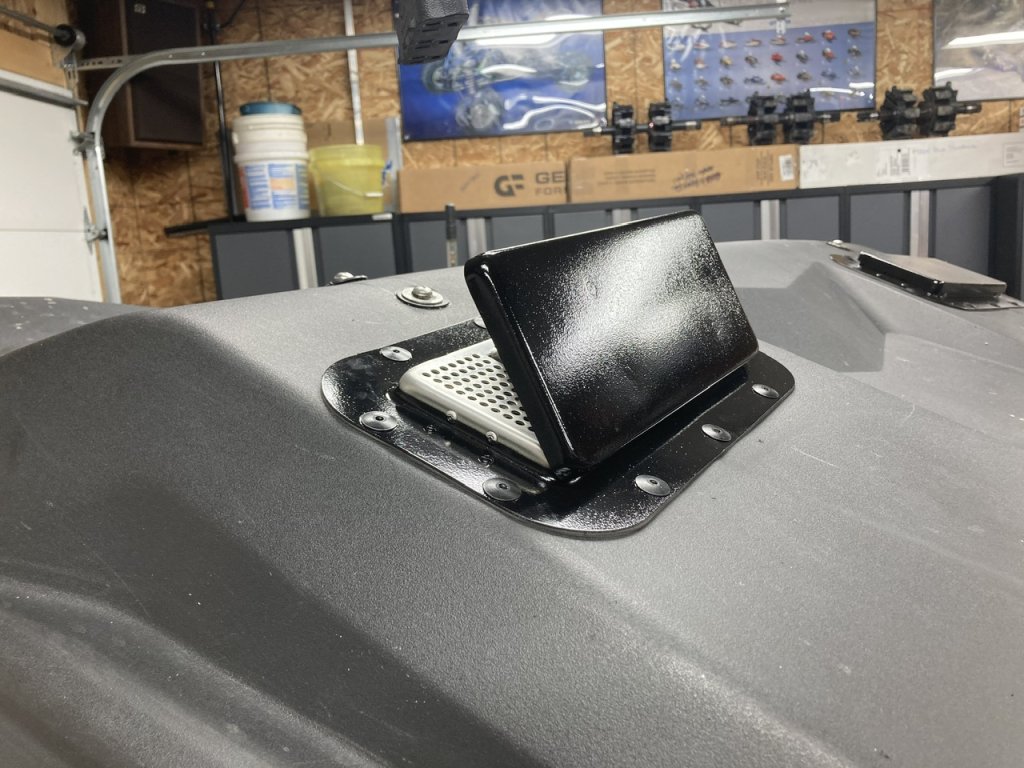

Also added dual vent to the roof for more ventilation or exhaust depending how you rock them.
Removed my small LED light bar and added a 40” curved light bar.

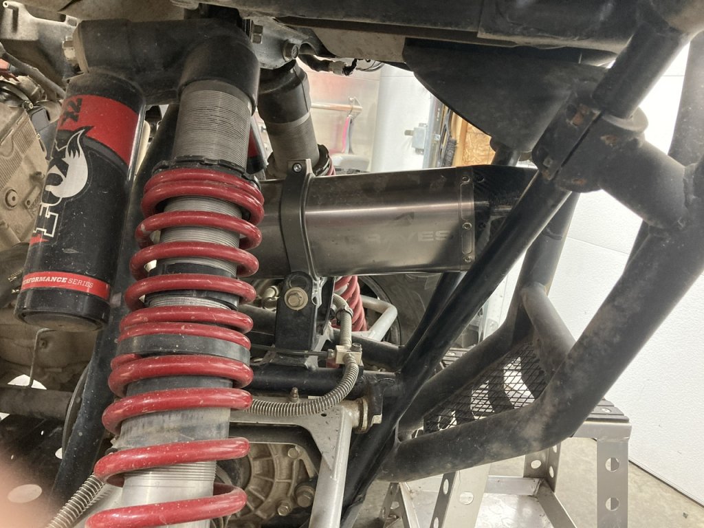

Also End of last year I added a Full Graves Exhaust and Flash.

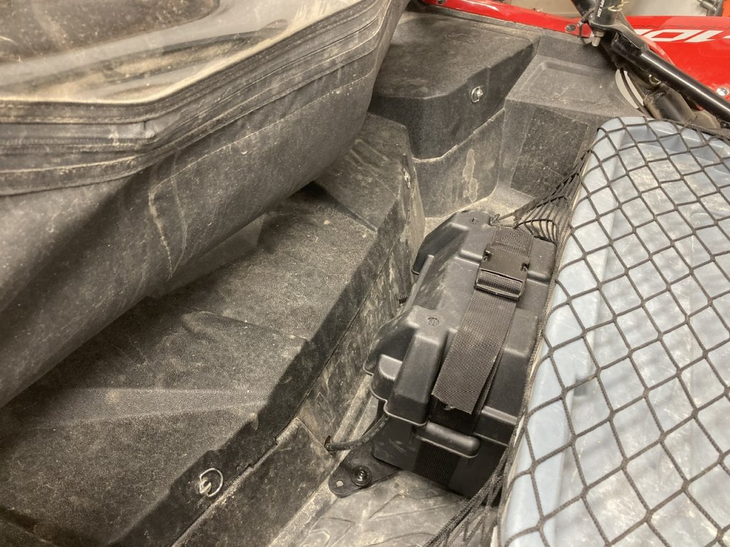

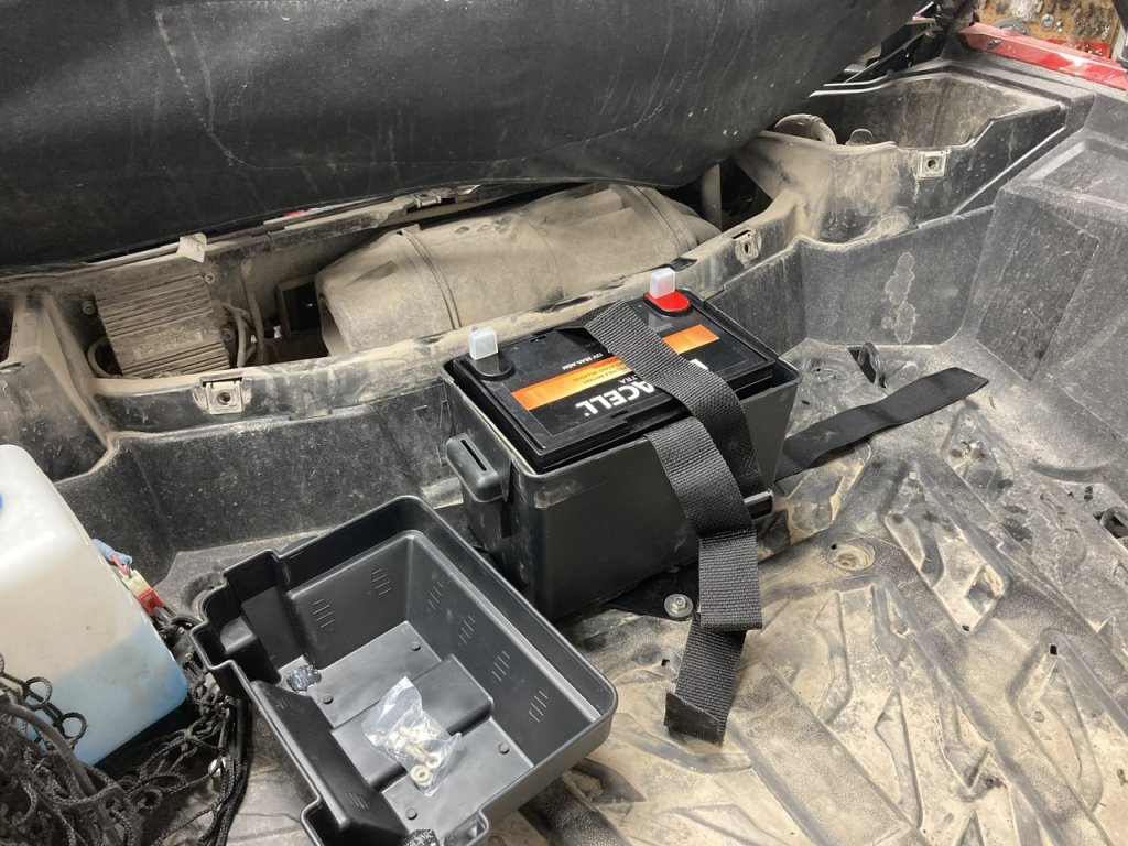

View attachment 172714View attachment 172718

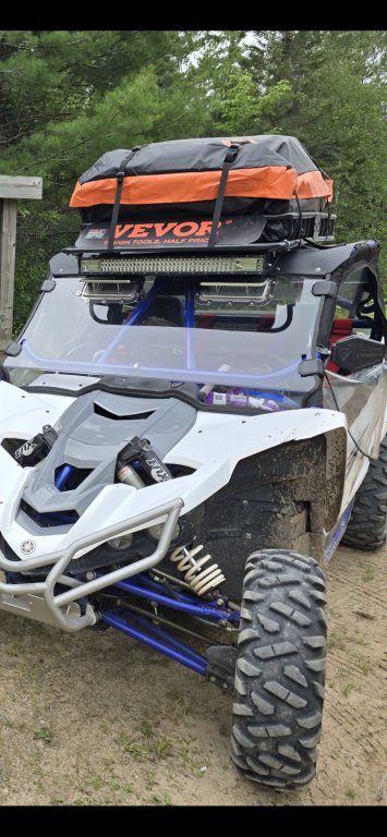

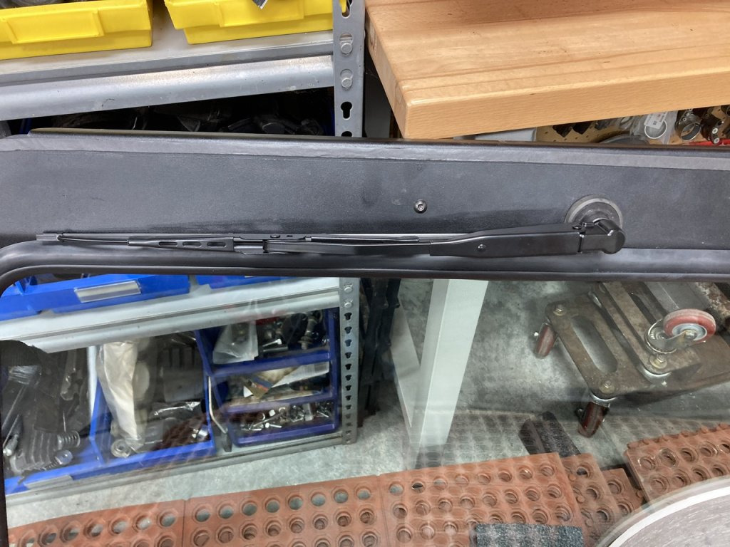

View attachment 172726View attachment 172712

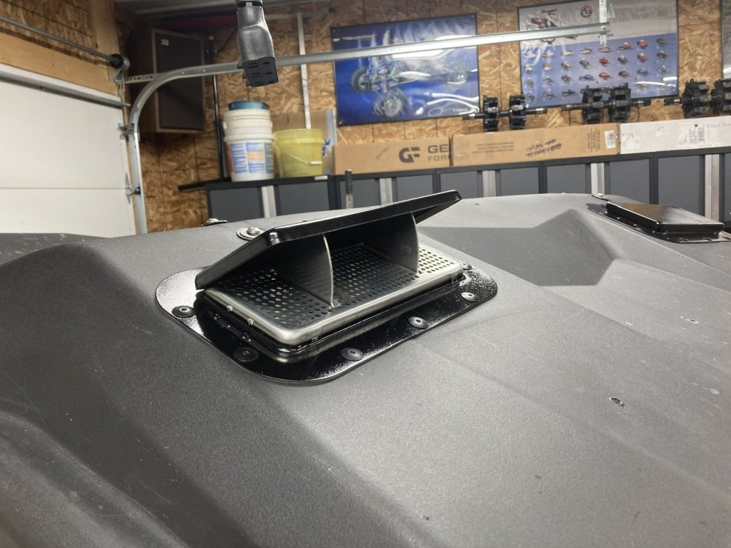

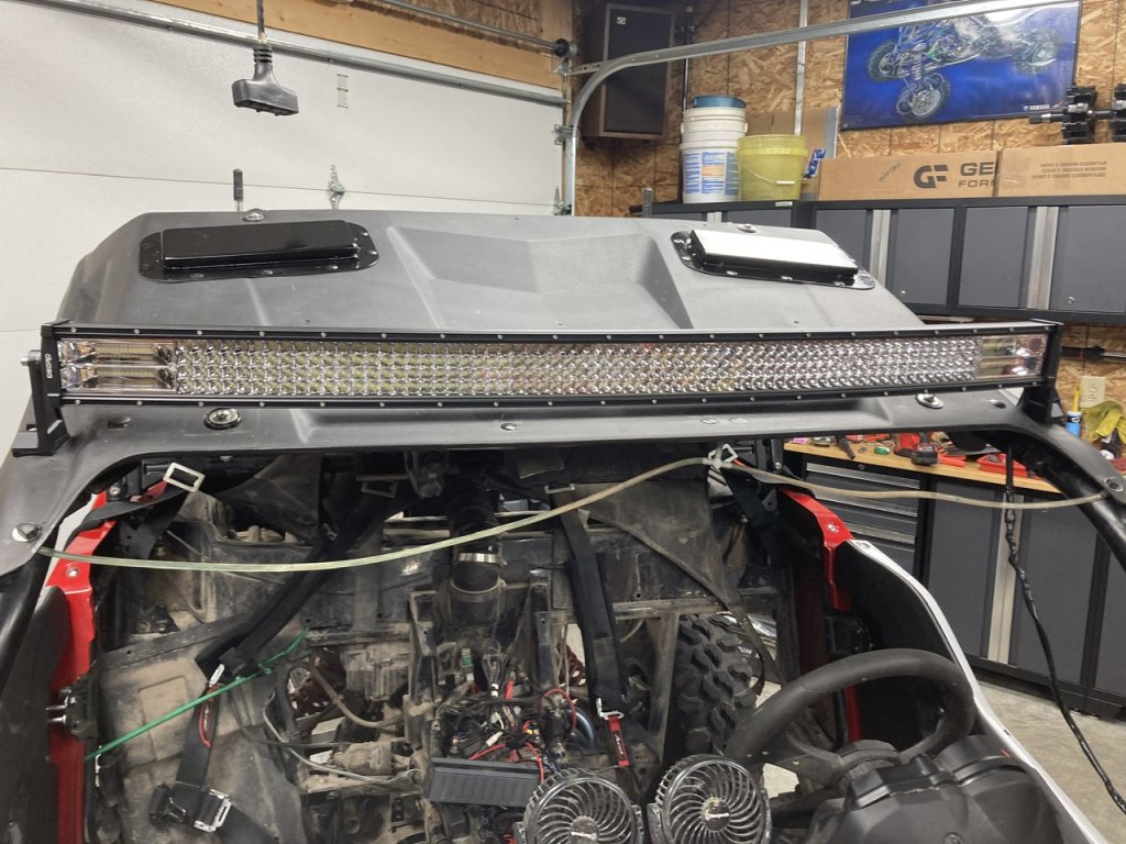

How did the roof vents work out?
Looking at adding some to my yxz.
- 21,885
- 9,476
They pull in some but not as much as I hoped. I think my light bar is is blocking the air that could be rammed in.How did the roof vents work out?

I have a flat roof and was concerned that the air off the windshield would go over the top of the vent.
- 21,885
- 9,476
That could be my problem. But when you flip them forward they do help pull out cab heat.

I mounted the vents in the windshield.
With the soft sides, front and rear windows it will create a positive pressure in the cab and keep the engine heat out.

How does it work?I mounted the vents in the windshield.

It will blow air at my face if the vent is in the full open position. I just run it one notch from full open. The vents are 5 position so still plenty of air coming in.
Works best with soft sides closed.

Interesting. How about dust?It will blow air at my face if the vent is in the full open position. I just run it one notch from full open. The vents are 5 position so still plenty of air coming in.
