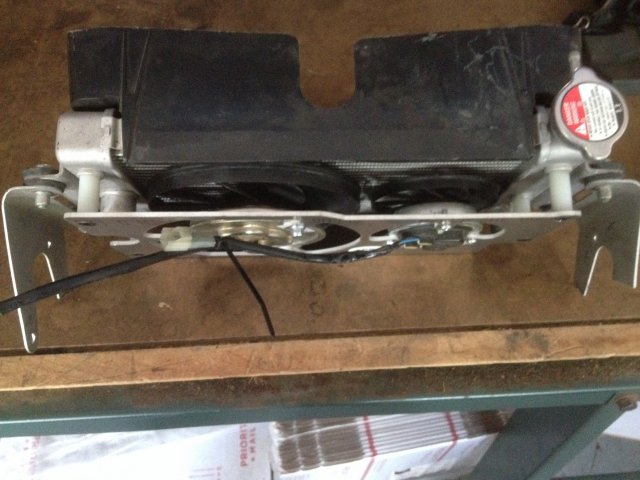

Spent the morning pulling my test set up off and finalizing this product. I got all components on order. I may have kits ready to ship by the end of next week.
Complete kit will retail for $125.
Complete kits minus the fan will be $95.
The fan required can be from any 06-16 apex, or 10-16 vector.
Both kits include plate, and all mounting hardware needed to install. The kit will work with the stock steering post orientation. A steering relocate is not needed.
At this time I don't think the kit will work with a trail tank. I will confirm next week once I get the components in hand.

Did my final fit up with the hardware and the kit went together perfect. They only thing I'm waiting on now is the wire lead for tying in the apex fan. They did arrive, but I mixed up the plug end that I needed on them. Should have the correct ones next week.

All parts are now in stock. I've sent a few pms to those that expressed interest in the product.
Couple things to note. The Radiator does not need to be removed nor do any hoses disconnected for the plate to be installed. You will need to remove seat & plastics etc to get gas tank off.
This product will most likely not work with a trail tank. If you have a steering relocate then the kit will work, however you will need additional spacers to bump radiator forward.

In hard pack conditions with minimal snow dust the nytros tend to have issues with overheating. We tested the dual fan set up this past February on hardpack ice trails for half a day. I couldn't ride the nytro with just the stock fan. With both fans running I was able to ride the sled with out an overheat light. I've also had trouble with my nytro overheating if I am breaking trail off trail in the woods at slow speeds. I'm extremely cautious when off beaten path and when there is not much track speed there isn't a lot snow hitting the front cooler.

Been getting a lot of questions lately about whether this product is better than a tunnel cooler.
Tunnel coolers work very well. The downfall with a tunnel cooler is that it's most effective when there is adequate snow dust. In all my experiences the nytros run hot when trails are hardpacked/icey with minimal snow dust. The dual fan kit is effective regardless of snow conditions. The extra fan pulls more cfm of cold air through the radiator to dissipate heat. The dual fan kit is also very effective at slow speeds when there is not much track velocity to throw the snow onto the coolers.

A friend put this on his nytro after overheating in low snow, works great. I wish I had one for my sidewinder. I overheat in low snow, he doesn't.
