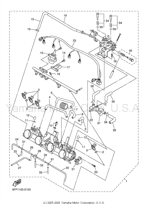

I think he means the valve it self. Having never seen a IAC on a apex I beleive its the top thing in the first pict you posted. That tube like cylinder should be the iac valve, check to see that it moves freely and if you have a source of vacumn you can test them to.

The IAC (idle air control) valve / pintle is sealed inside the long aluminum housing right on top of the fuel rail above the throttle bodies. This unit will have 4 brass air adjustment screws in a square configuration, to sync the throttle bodies... (it is NOT serviceable, it's like a thermostat and is moved by coolant heat not vacuum like a fuel press reg.)
It will have 2 soft rubber hoses / elbows that go to a black plastic resonator and then another from the black box to the airbox on the left side (above the clutch) of the sled. (in your second diagram)
If the air flow is anyway restricted to this, it runs just like you described. The fuel system / PCM anticipates the additional air flow from this and is compensating additional fuel for it. No air = too rich.
You can try blowing a little shop air into this to make sure you hear the air flowing thru.
Perhaps one of you might have plugged the hose to prevent misc parts falling in when you tore it apart the last time. Or it's kinked closed...
We've seen rags and shop towels inside charge tubes and intercoolers before. Customers couldn't figure out why the sleds wouldn't run.
